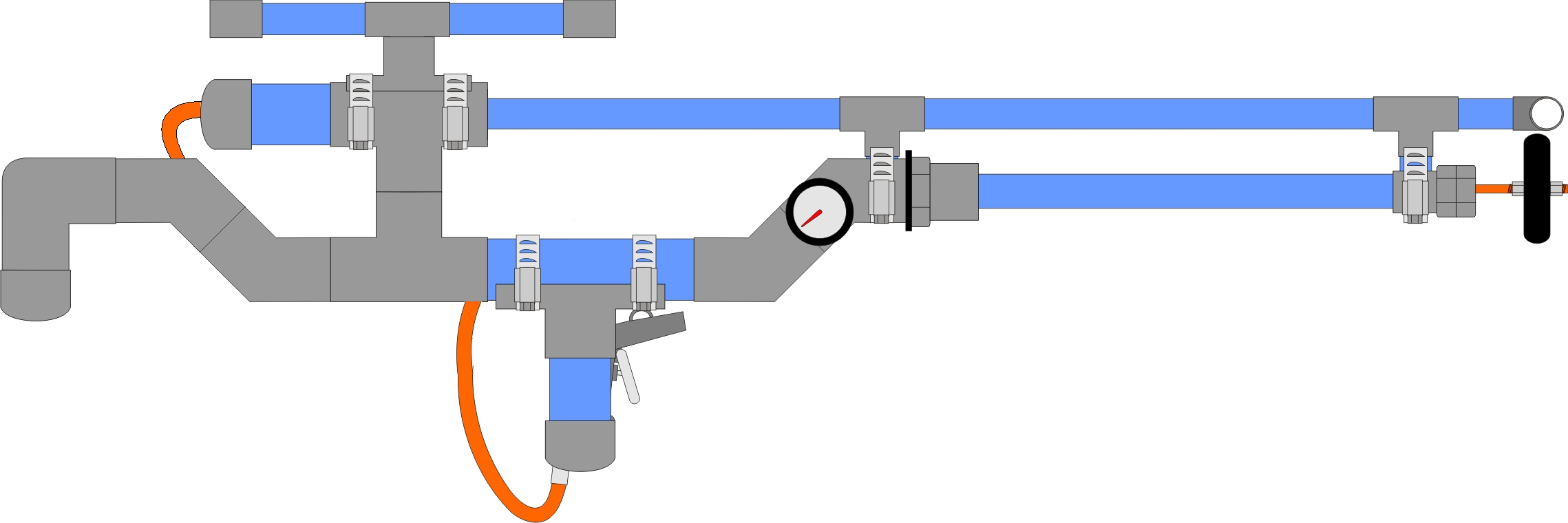

Edit: I have posted this already: I have removed the spring from my sprinkler and it closes nicely and opened 1 hell of a way could this be harmful to the diafram?

Nah mate it shouldn't hurt the valve at all. It will just increase the flow, and the opening time. Both huge pluses in my bookBlackH wrote:Yes me to, I'm going to a farm next week so shoot all you want NICCEEE!!

I can see you've got some good experience with pistons so why not stick in a piston valve to replace the sprinker valve? the increase in performance would be very, very high.....and make your pump a bit more practical (you wouldn't need more then 80 or so psi for a strong shot)

Also, remember that if you make the chamber bigger, you will need a larger barrel to compensate. Pneumatic guns don't suffer the problem of pressure only lasting a fraction of a second, so you have maintained pressure. The ideal barrel length is chamber volume x BAR. However this would be unrealistically long and pressures tend to fluctuate from launch to launch. get a nice long barrel on there though if you're operating at 90 PSI.

Yes that is why I left the piece of blue pipe over at the t-joint so that I can insert a female strew in cap thing to make my piston fit in there, will soon happen. Going to visit the parents and my dad has his own building company and he has allllllll the tools, darn!!

Mitchza89 I was thinking now if I use a piston valve and the air is pumped in the way I do now with the air coming from the chamber side of the valve and not from behind the valve would I have to put a spring behind the valve?
Here is a few more pics and a shot at 30m
EDIT: did a little mod on the gun to look like my plans.
