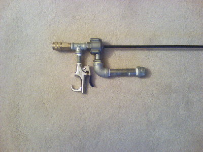

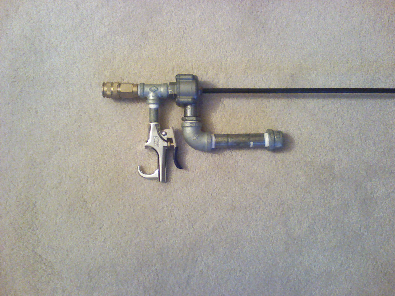

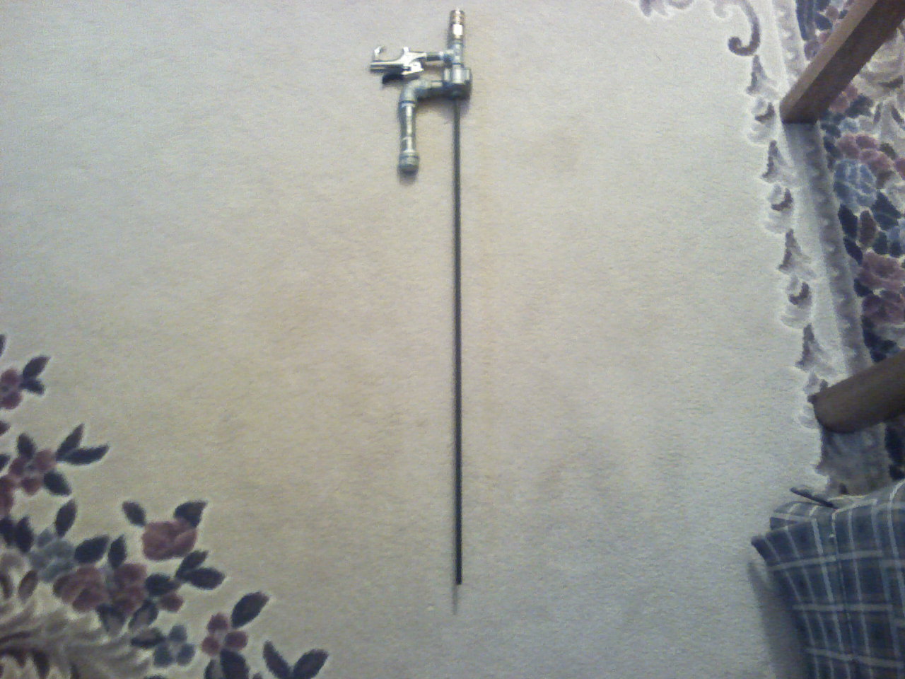

This is just a spare parts gun that I made while I was bored. I usually operate this at 25 to 200 PSI, but I may go a little bit higher.
Chamber:
6" x 1/2" galvanized steel pipe
Valve:
1/4" QEV
Pilot:
Standard compressor blowgun
Barrel:
5/16" brake line
I probably won't be able to do any damage pictures or videos for a while, because I am pretty sick right now. I might make a video when I figure out what's wrong with me.

This is one hell of a gun made out of spare parts.
Impressive.
How's preformance? Accuracy?
Impressive.

Accuracy is pretty good, and the power is great. GGDT says 776 FPS @ 200 PSI with an airsoft bb.
