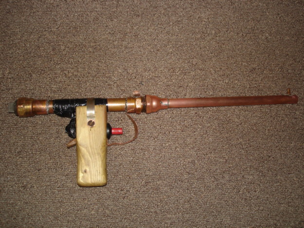

This is my first and only mini (but hopefully not last). After several months of random upgrades I decided to register to this site and post it. The mini is partially based on the mini-spud, with several differences. As you can see it has iron (copper) sights, which are actually quite accurate. I use them to hit a tin can up to about 10-15 meters away. I estimate it's range to be about 30-50 meters with propane, depending on several variables. The barrel is 50 cal. (aka 1/2 inch copper pipe) and is 10 inches in length. The combustion chamber is about 9" long and 3/4" copper pipe. It uses a BBQ ignitor and has a copper trigger gaurd and wooden handle. Any questions or comments are most welcome.

Yeah I was fortunate enough that almost all the materials were down my basement. I also found copper pipe in the trash where they were rebuilding a house. :wink:
Another thing, as you can see the barrel is removable, i tried other lenghts to see how they performed, anything shorter was simply just louder and less accurate, anything much longer was almost silent but less powerful.

The pipe was all 1/2", I didn't have any pipes smaller, or a coupling for anything larger, the sizes i tried were 4", 6", 10" (current) and 16" (WAY to big lol :shock: )
Interestingly enough I had an idea that I got from paintball guns to make a stirational patern partway down the barrel, using drilled holes at precise intervals, to give it spin, unfortunatly all it did was decrease the power and made a wierd but cool sound.
