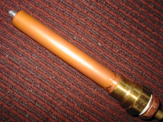

Well I am not going to go all indepth on this one.
Lenth: 160mm
Barrel: 5mm
Valve: 1/2'' piston valve CO-AX Pilot/fill: Shrader
Body:1/2'' Type M copper
Ammo 4.5mm bb's
http://www.spudfiles.com/forums/piston- ... t8157.html
For people who don't know how piston valves work *First Animation*
250-350 PSI
I have shot this thing through a pop can filled with water,2 empty pop cans in a row, cereal box with the plastic bag inside leaving a dent in a metal backstop.
I have caused dammage to plywood, milk jug filled with water, metal backstop.

Thanks Spudfarm what do you think? Personnaly this is my favorite marker gun and I think it rivals all of the minis on this site other than the ones made by JSR.

So what do yo think? Yeah I know the first time I fired it I was like damn! it pretty loud for it's size too Louder than My first working marker gun.
xnt rnm ne z ahtbg
xnt rnm ne z ahtbg
It looks pretty solid to me. It would be cool if you could find a little more elegant way to pilot that thing. Other than that, nice job!

Yeah I wanted to make a push button to pilot it with one hand but I like this.
