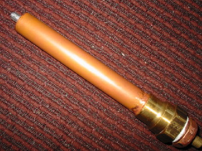

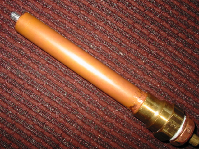

Well I am not going to go all indepth on this one.
Lenth: 160mm
Barrel: 5mm
Valve: 1/2'' piston valve CO-AX Pilot/fill: Shrader
Body:1/2'' Type M copper
Ammo 4.5mm bb's
http://www.spudfiles.com/forums/piston- ... t8157.html
For people who don't know how piston valves work *First Animation*
250-350 PSI

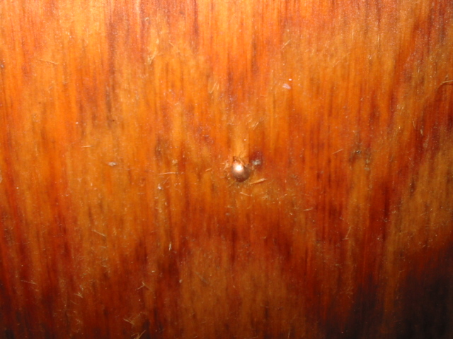

bb imbedded in plywood

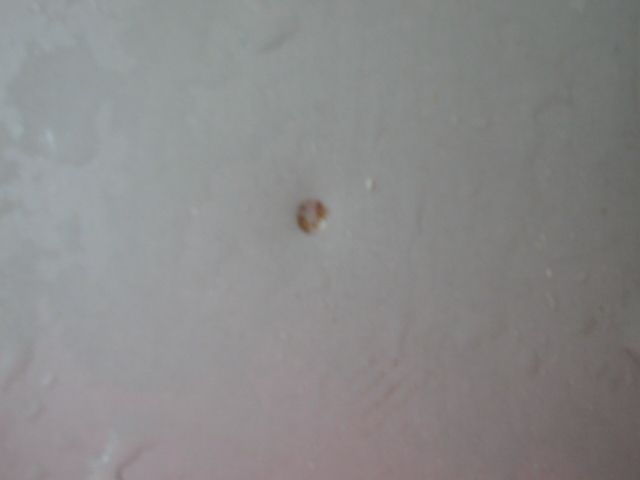

dented metal backstop

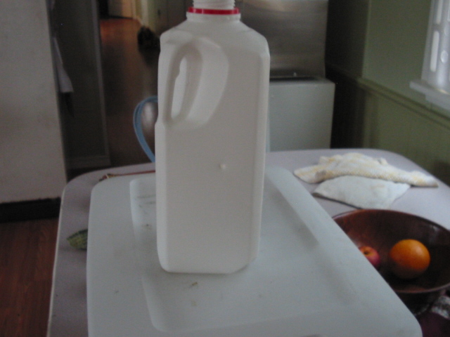

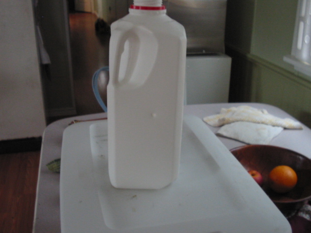

Milkjug was filled with water you can just see the hole and on the other side you can feel a dent.

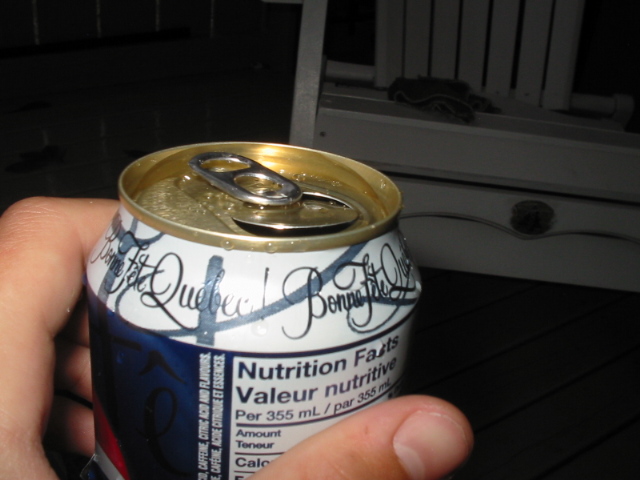

Sorry for the double post but I have an interesting phenomena to record While I was making a video of the marker gun shooting through a pop can full of water and once I shot it the tab that you crack down poped outside the can I think it had somthing to do with the water creating a preasure wave and pushing it out.
xnt rnm ne z ahtbg
Has thanked: 581 times
Sticky_Tape wrote:Sorry for the double post but I have an interesting phenomena to record While I was making a video of the marker gun shooting through a pop can full of water and once I shot it the tab that you crack down poped outside the can I think it had somthing to do with the water creating a preasure wave and pushing it out.
High velocity projectiles passing through fluids will do that, good job on the launcher :)
