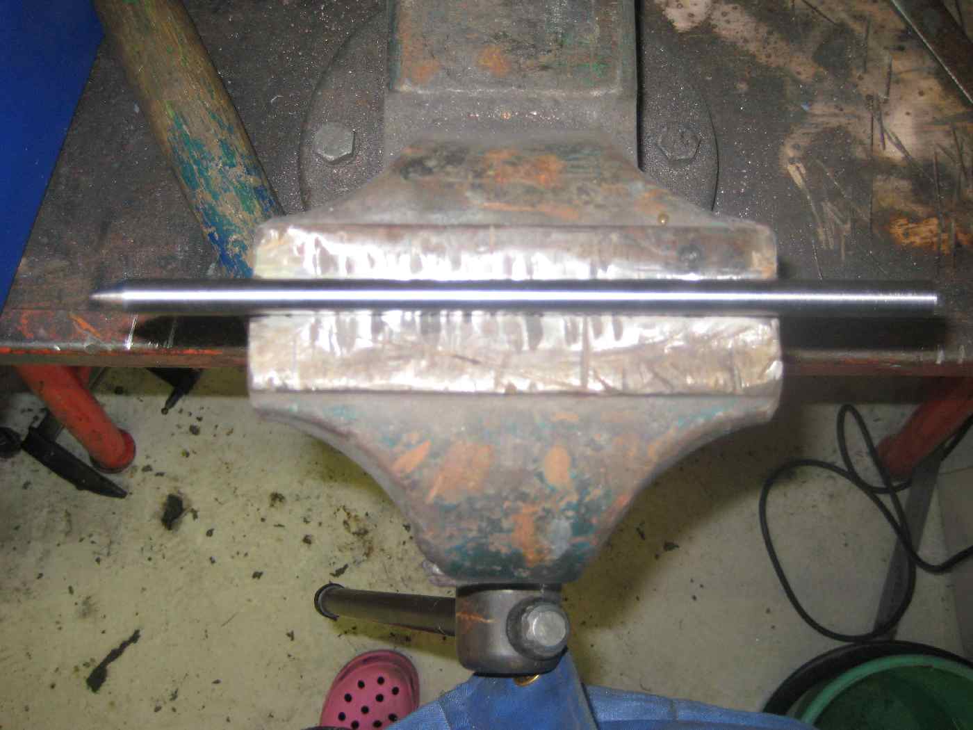

i just made a bigger dart now and will post it as soon as i have resized it
edit: pics
hardened not polished
polished.. (halfway i just used sand paper there and not a polishing rag)
look at the fins and the penetrator<br /><br />(164g)
(164g)

well i got the fins to stick on the dart..
i think those fins will fall of when they hit something (if they even survive in the barrel)
well, i am pretty pleased by the outcome of this, looks pretty cool eh?
that would be the angle, it is slightly more shallow than the other fin stabilized dart
