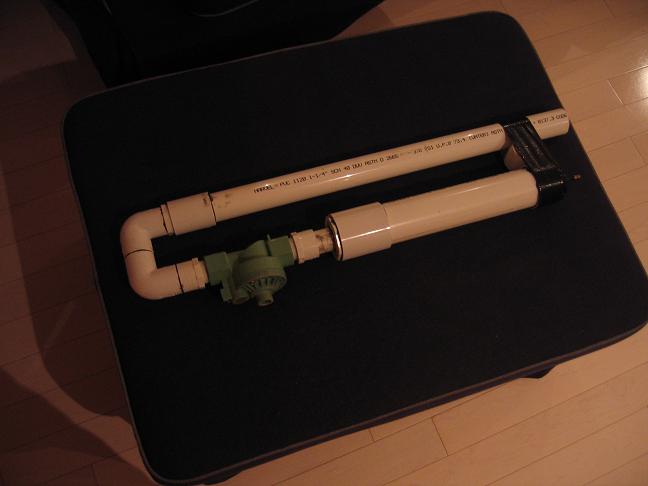

After 3 ball valves, 2 sprinkler who failed because they where badly modded and 2 unsucessfull coaxial...
This is my last spudgun!
Very simple:
2 inchx1foot chamber
1.25inchx2foot cannon
non-modded sprinkler valve
And thats all!
(i only need to buy the 1 inch sprinkler valve(the one in the picture is scrapped))
AND I DONT WANNA EAR ANY "MOD IT!OR PAINT IT!" OK???
Here it is!(pretty heavy for it size)
Your C:B ratio looks to be about 1:1. It's going to be kinda weak. I wont tell you if you don't want to ear it. lol! :P

jrrdw wrote:Your C:B ratio looks to be about 1:1. It's going to be kinda weak. I wont tell you if you don't want to ear it. lol! :P
I doubt it. I remember someone telling me the ideal ratio for a pneumatic was well below that of an ideal combustion ratio, at least in terms of efficiency. however, pneumatics are a lot less susceptible to ratio problems, and thus people can bulk up their chambers without any problems. To be honest, I think 2:1 ratios are pushing it a bit (I am quite guilty of sometimes going above 2:1); 1:1 should be fine.
with pneumatic guns you are free to choose whatever ratio you want... it is completelly up to you, the power you want to get from it and the kind of compressor/pump you have...
you shouldn't say that 1:1 or 2:1 ratios are ideal for pneumatics... 1:1 can be an overkill if you use high pressures...
????What???
1:1 is the best ratio you can have!
and 2 inch x 1 foot is the chamber limit size for my bike pump...

Eh, you need to make a basic combustion. You won't have any problems with valves, which seem to be giving you most of your trouble
I cant and prefer pneumatic cannon, funnier and more powerful
I totally agree
And no its not weak MR.Sjog it can break in two a 1inch thick wood plate...

The way it works with pneumatics is that the bigger the chamber, the more power you have. However, the advantages of a large chamber suffers from diminishing returns, so after a certain point you'll just be wasting space.
I wouldn't rush to say best, but for a fixed barrel size, 1:1 is a good compromise between power and efficiency.
In my opinion, anything between 0.5:1 and 2:1 for a pneumatic is a good choice. Obviously, which end of that scale you choose is your own decision.
