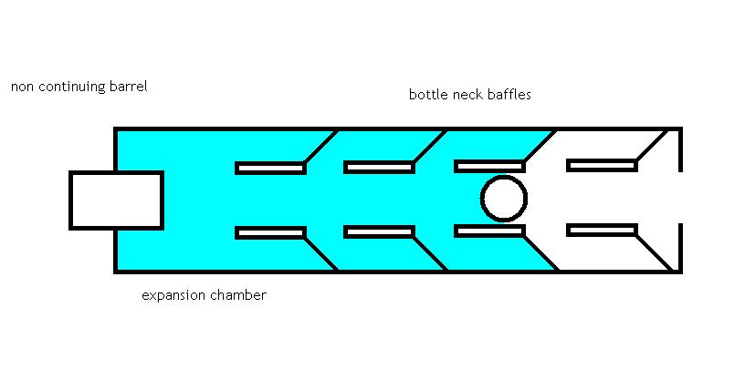

Here is a drawing of a silencer I created. The expansion chamber fills up with air that was pushed down the barrel and re-directed by the baffles. Then the air is then let out threw the vent holes on the exterior of the silencer located on the aft end. The expansion chamber section should be filled up with no less than steel wool. This concept is very similar to firearm silencers and has been proven successful in many tests.
I hope this will inspire and help all builders interested in the idea of silencing their cannons.
Cheers! -Xxplosive42o 8)

how do you make that kind of silencer

xplosive, firearm silencers do not have holes in the exteral wals for a reason, you do not need them it would mke it less efficient

The outside of the silencer or "shroud" can be constructed from PVC with wooden endcaps on each side. Make sure to drill holes in the shroud on the correct side to create the expansion chamber vents. The baffles could be built from plastic soda bottles by cutting the top piece of the bottle off (the top piece = the portion above the label). Then punch holes into the baffles to allow air to draft from baffle to baffle to finally exit the expansion chamber holes pictured above. Before sliding the shroud over the baffles to put into place, pack some steel wool in there and you're good to go! It's a simple design I came up with, but has worked pretty darn well.
I know Carlman, but I made both variations and the holes seem to help for some reason. I believe it might be the pressure that builds up in the expansion chamber... I dunno. But nonetheless through my personal experience with the design this has been the way to go. But to each their own! Cheers.

STHORNE wrote:Image
yellow = airflow
But why the exhausts at the back?

[quote=" Before sliding the shroud over the baffles to put into place, pack some steel wool in there and you're good to go! It's a simple design I came up with, but has worked pretty darn well.
[/quote]
why steel wool what does that do

Steel wool has been shown to aid is sound attenuation. That is why is has been used in everything from car exhaust silencers to vacuum cleaners. I am uncertain of the exact reasons, as I am not a expert in material research.

steel wool is used in situations where hot gases are involve, because it aids in cooling them. As every spudder should know, if you cool a gas, it contracts, so there is less of an explosion. That is why we can never hope to silence a pneumatic as much as a combustion, because there is still there sheer volume of gas to deal with. Steel wool will do next to nothing in a pneumatic, other than possibly make a little turbulence.
