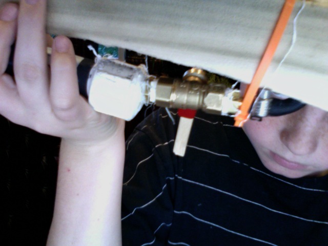

ok here is my new bb gun
chamber: 3/4 inch sch 80 pvc
barrel:2 feet of 1/4 brake line also 3 feet of 5/16 brake line
valve:1/4 ball valve
fill valve: screw in schrader
This is a small, but powerful little plinkler. It can shoot straight through a steel soup can from about 25 feethttp://www.youtube.com/watch?v=wKGoqNsJEiU&fea ... annel_page

Looks pretty good. Take out the Zip ties and it would be cleaner in my opinion, but otherwise pretty cool.
Improvement from the blowgun... lol.
and nice eyes in the first pic.....

Good improvement. I would suggest a smaller chamber because with that slow valve, the bb would be gone way before that chamber is close to being empty. What pressure do you use?

nice gun 2 things that can make it better though:
1. get a sprinkler or QEV valve and then use the ball valve eto pilot it, it'll only cost about $15 to do but will make a huge difference.
2. this is a more long term improvement, replace the pvc chamber with copper or brass because it looks like it has all brass fittings except for the chamber, doing this will allow it to handle much higher pressures, and has the added bonus of you being able too fill it using a co2 tire inflator, which can be bought from any bike store.
is that you in the photos? you look awfully young to be making these
(take it as a compliment)
I understand a 1/4 inch qev, but a 3/4 sprinkler is way overkill.get a sprinkler or QEV valve and then use the ball valve eto pilot it, it'll only cost about $15 to do but will make a huge difference.

Pretty cool gun you got there. Definitely get yourself a QEV! You could just use one of those sprinkler valves. Finally, get rid of those zip ties so you can work on some aesthetic improvements. Keep building man! Cheers 8)
And for the first picture? You creeped me out; therefore, I must return the favor! muaha
*removed picture* I know I know... I went far on that one. But still, it was funny.

Good heavens, I could have gone all year without that...the creep out factor went up by a 10x factor....
Might want to keep in mind we have some youngish eyes around here.
Probably overkill until performance is lost. Didn't someone here prove that fact?overkill is good in this hobby my friend
