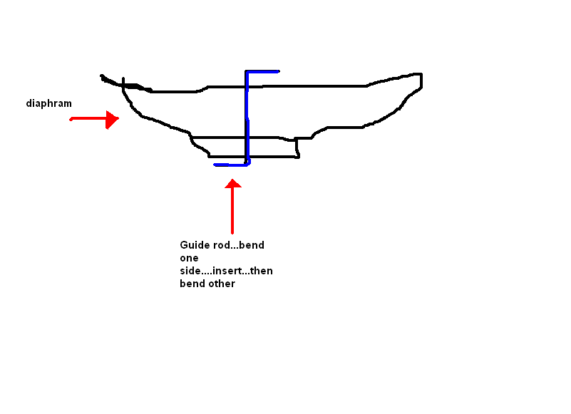

Cosmic Muffin wrote:what do you mean bend a small rod?
the guide rod?
cos i thought you either take it our or leave it in, when would you need to bend it.
Yes, the guide rod, with the bunnings sprinkler valves you keep the rod in, all you have to do is bend it so it stays in the right spot (its original placement is in the way of where you need to drill)
Old but extremely detailed diagram....I know, I spelt diaphragm wrong.
