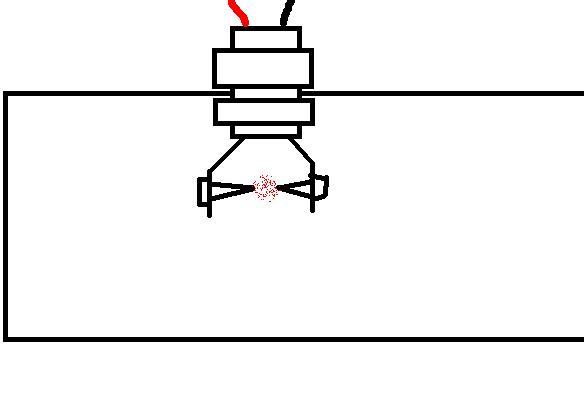

just hook 1 wire up to the chamber as a ground, then drill a holw in the chamber and put the second wire through it (insulated) until it's about 1/8" away from the chamber wall or less. I'll make a pic in a sec...
edit pic up
yup
yup

Make a threaded hole or reduce the end of the chamber to a small diameter. Or use a T piece.
Then make a plastic plug which screws in, and then have a metal rod going through the center of that.
Use the metal rod and the chamber wall as electrode points, just like the wiring in the above post of Fishboy
