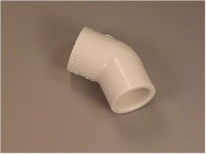

and a nsf-pw 45degree elbow
a dwv 45degree elbow

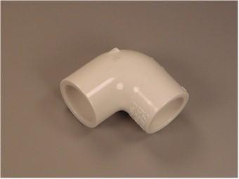

and an nsf-pw 90degree elbow
a dwv 90degree elbow

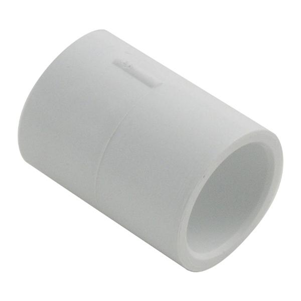

and a nsf-pw coupling, notice its longer
A dwv coupling, notice its a lot shorter
