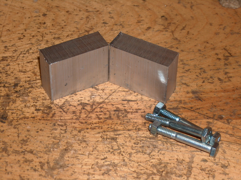

Materials:
Blocks of aluminum big enough for the mold. These are 2.5"x1.5"x.75" .
Three bolts, and two nuts. (I used 1/4" bolts.)
Safety glasses.
The basic materials. Start by deburring the edges of the blocks with the file.

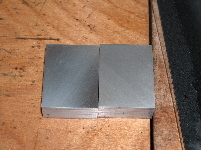

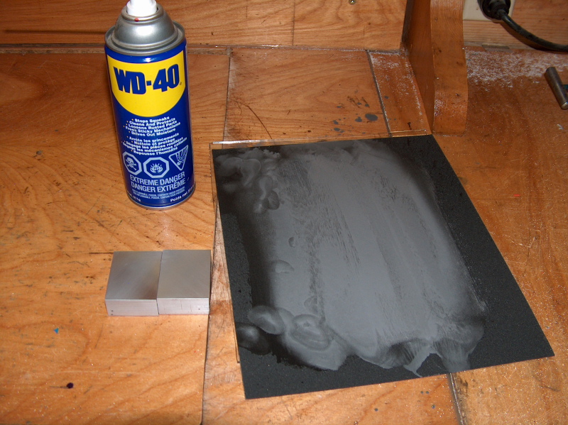

Pick the best side of each block, and wet sand it using the sandpaper on the piece of glass. Keep it wet with the WD-40.
This is what you're looking to get. Smooth and most importantly, flat.

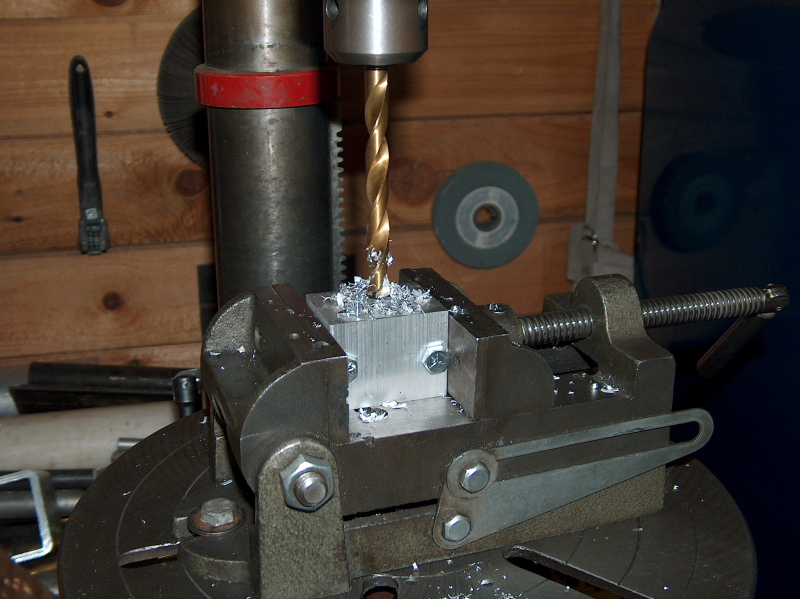

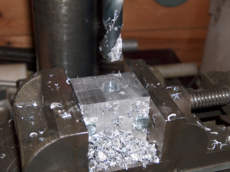

Now we need to CAREFULLY line the blocks up and secure them in the vise. One on top of the other. Drill through both blocks as shown so that they can be bolted together. Use WD-40 as cutting fluid. Keep the bit and the end of the hole wet.

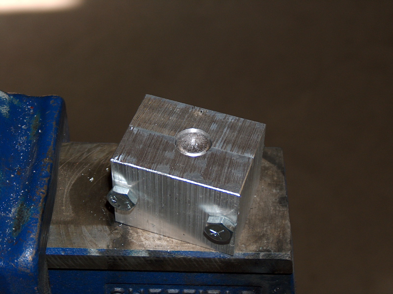

Remove the blocks, line them up, bolt them together. Then put them back in the vise, BOTTOM up. Drill a shallow hole DEAD CENTER as shown. 3/16" is plenty deep. The success of the mold hinges on this shallow hole, being lined up perfectly, so take your time, and get it right.

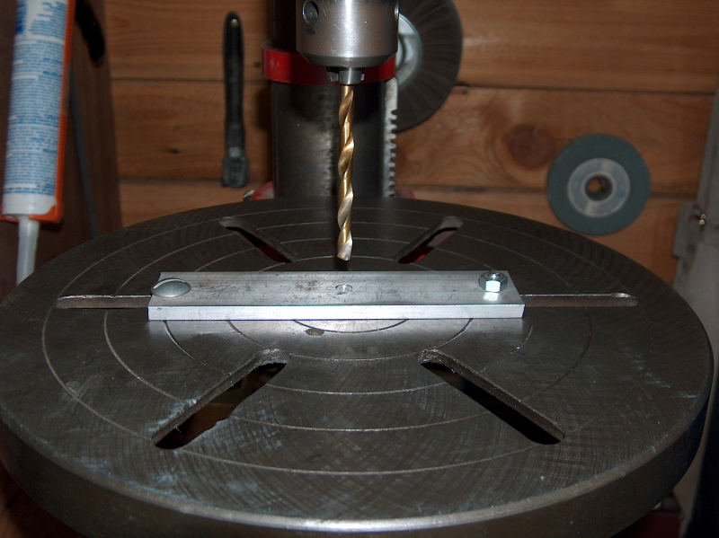

Drill a matching hole in a piece of flat bar. Do not drill all the way through. 3/16" is enough. Cut an alignment pin from one of your bolts. It should as long as it can be, with the blocks sitting evenly on the flat bar.

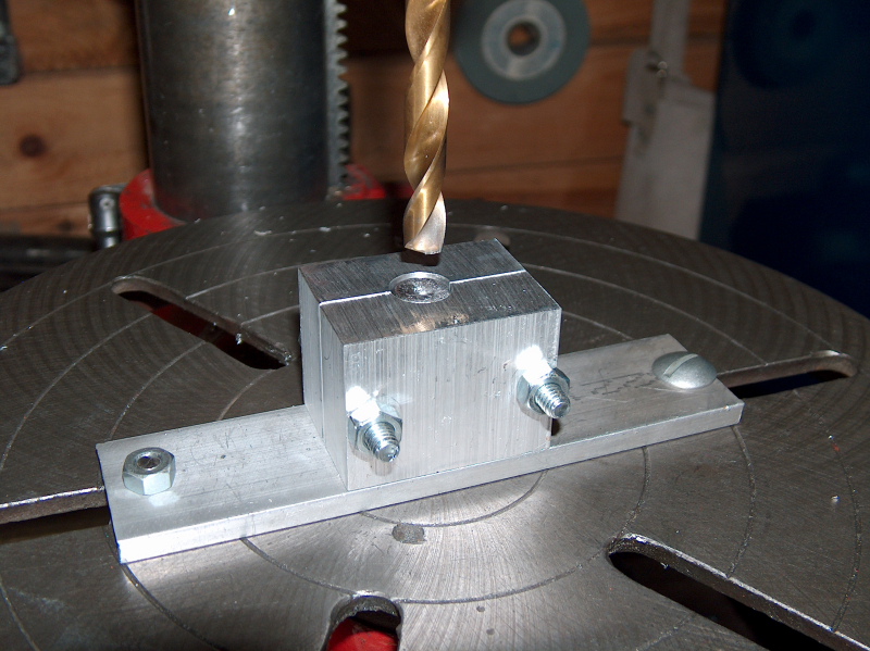

Bolt the piece of flat bar to the drill press. Using the same drill bit you used to drill the hole, VERY carefully line up the bit with the hole. Tighten things down, double check alignment.

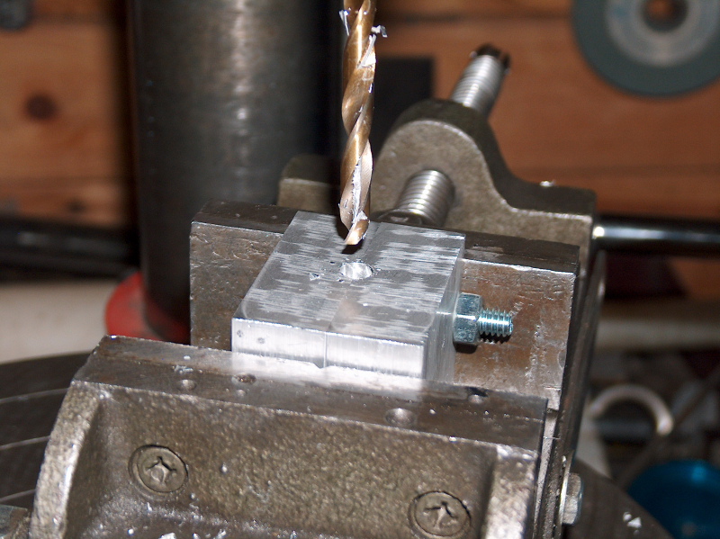

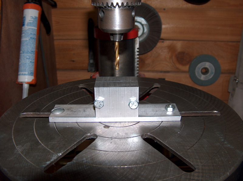

Replace the drill bit with a "starter bit" or short, stiff drill bit. Place the mold blocks "bottom" down on the alignment pin.  Drill a shallow hole.
Bolt the vise onto the drill press. Using the hole you just drilled, carefully line up with the drill bit as you did before. Snug everything down. (Watch out for cheap drill vises, they tilt the work when you tighten them.) Double check alignment.

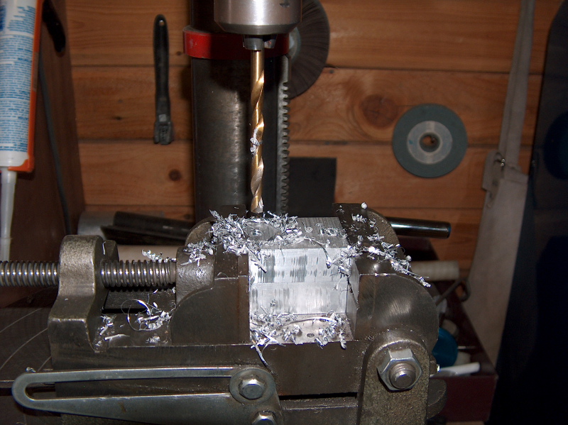

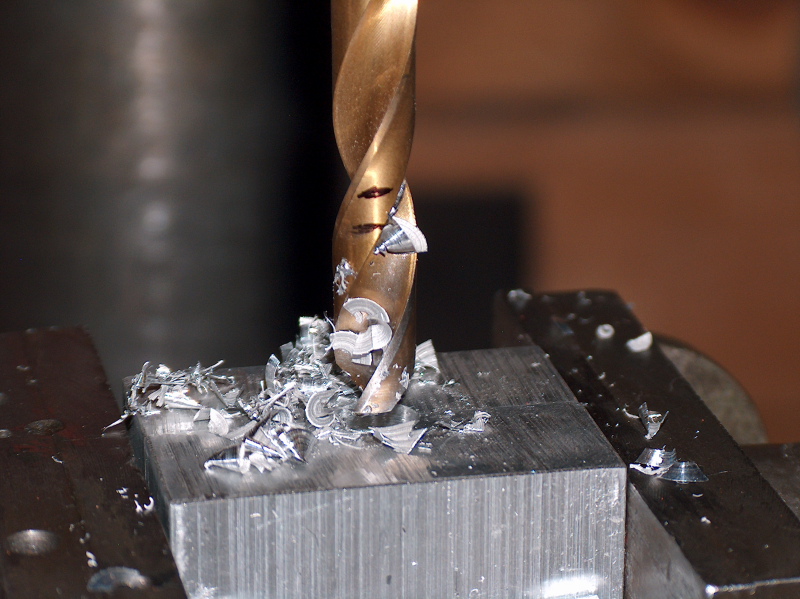

Start drilling. Go in steps of drill sizes depending on what you have. Take no more than 1/4" steps though. Use WD-40 as cutting fluid, and keep the bit and bottom of the hole wet.
You can mark the drill bit with a sharpie pen to help you control the depth.
Drill to final size with a SHARP bit. Feed to depth very slow, use a LOT of WD-40.

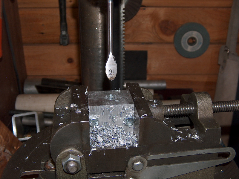

If you wanted a "pointed" slug you're done. If a round nose slug was more what you had in mind, you'll have to form the nose of the mold. Another member, blafen, suggested a modified spade bit a while ago, I thought this was a good time to try it. I used a bench grinder to modify the bit, cooling it frequently in water. Remember to grind the relief on the correct side. Look at a drill bit if in doubt, or ask.
Running at 500rpm, with a LOT of WD-40, the modified spade bit cut aluminum surprisingly well. Better than I expected.

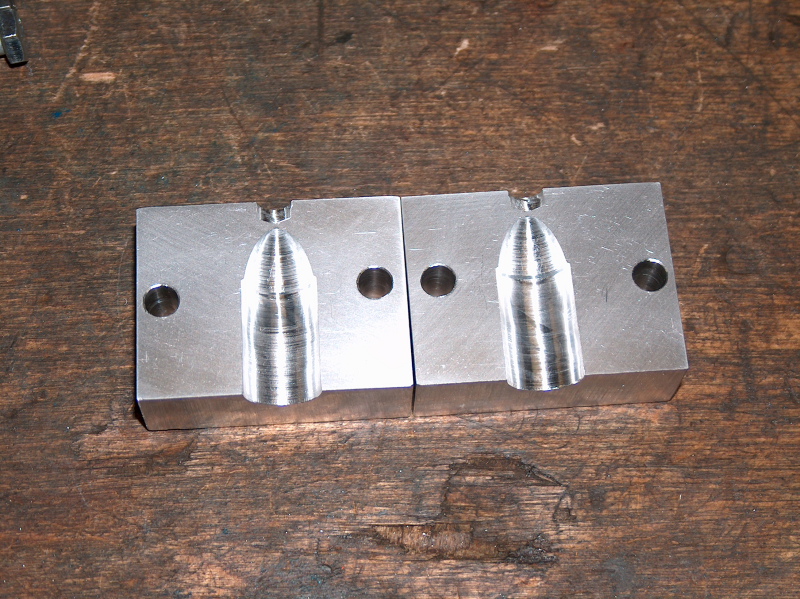

There you have it. It's not lathe cut to be sure, but it should be serviceable.
The wavy reflections on the machined surface indicate that the bit was wandering a little. A more sturdy machine and slower feed rates should make for an improvement.

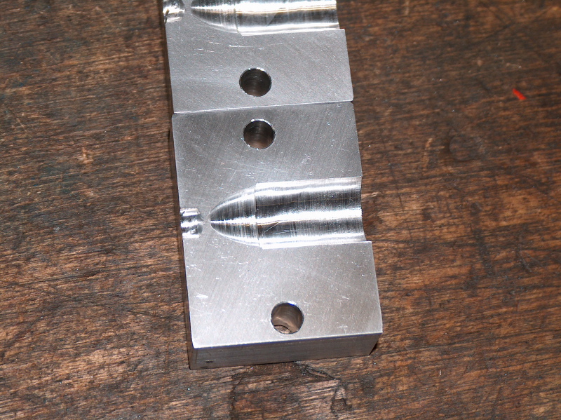

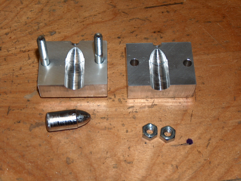

So how well does it actually work?
Pretty fair if I do say so. (I think I just did! :) )
I did pre-heat the mold somewhat, but the slug would have come out smoother had the mold been hotter yet.
Still, not a bad mold for less than an hours work with limited tools. :)

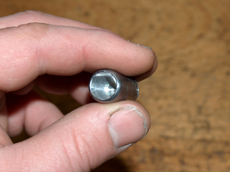

This what you're looking for?
It's the only backside I'll be posting here. :lol:
