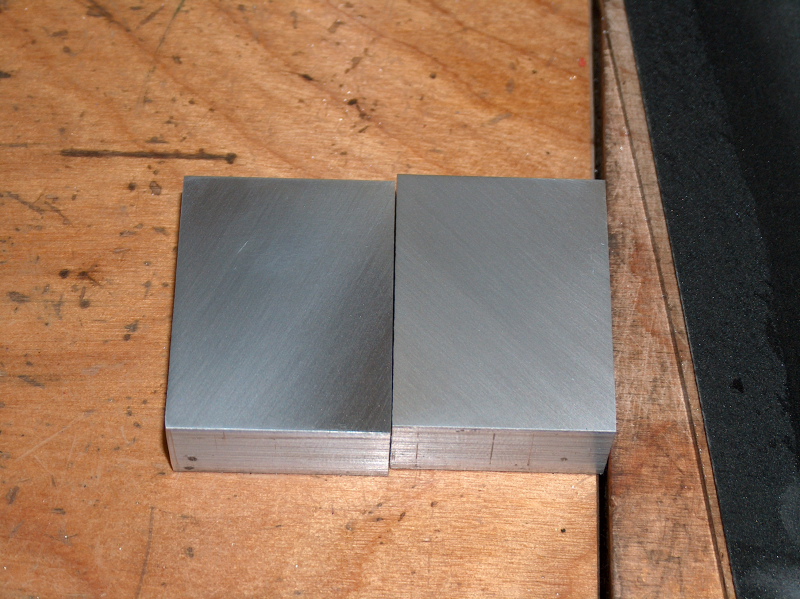

Blocks of aluminum big enough for the mold. These are 2.5"x1.5"x.75" .
Three bolts, and two nuts. (I used 1/4" bolts.)

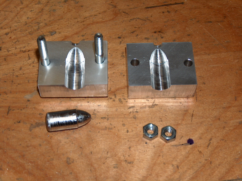

Easy split mold for foster slugs (Picture intensive.)
- Gippeto
- First Sergeant 3
- Posts: 2504
- Has thanked: 2 times
- Been thanked: 17 times

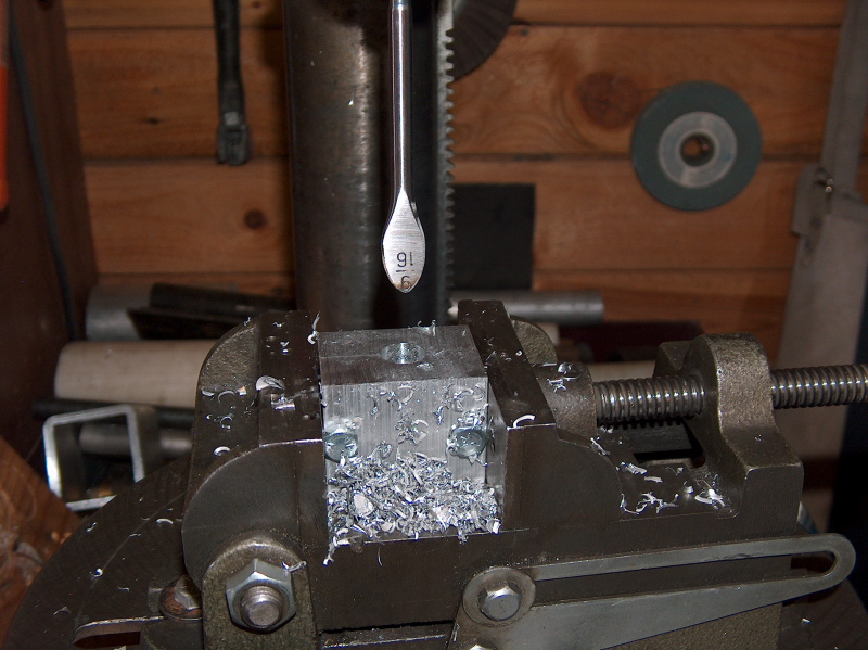

- If you wanted a "pointed" slug you're done. If a round nose slug was more what you had in mind, you'll have to form the nose of the mold. Another member, blafen, suggested a modified spade bit a while ago, I thought this was a good time to try it. I used a bench grinder to modify the bit, cooling it frequently in water. Remember to grind the relief on the correct side. Look at a drill bit if in doubt, or ask.

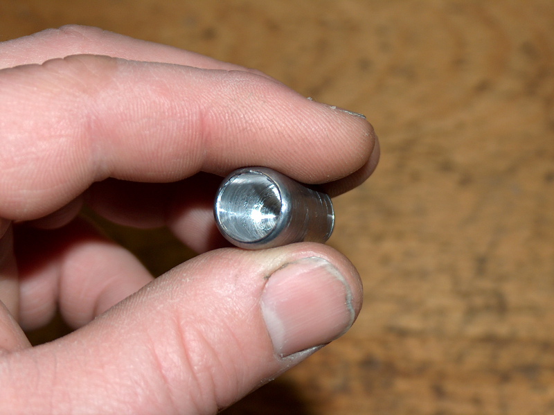

Very nice, does it have a third part for the hollow tail or is that drilled later
- Gippeto
- First Sergeant 3
- Posts: 2504
No, no lathe turned parts for this one.
The idea is a mold that can be made by those having fewer tools. (Same as the stirrup pump.)
The aluminum plate will be used to line the mold up with the drill press, so that the tail can be accurately drilled out.
This should allow easy modification to slug mass and center of gravity.
And with a preset depth stop, reasonably consistent ammunition should be a real possibility.
Not fast, but do-able.

Sometjhing that could be done relatively easily to make it cast hollow tails would be to take another piece of flat stock and set it with alignment pins or screws, and drill and tap a hole for a bolt to thread down through it and once the bolt is installed into the blate take a file or sandpaper and remove the exposed threads... This way you could cast them hollow and still not require a lathe...

Another option is to cast a heavy nose in a section of pipe that is the same external diameter as the interior diameter of your barrel...jeepkahn wrote:to make it cast hollow tails

So how well does it actually work?
Pretty fair if I do say so. (I think I just did!
I did pre-heat the mold somewhat, but the slug would have come out smoother had the mold been hotter yet.
Still, not a bad mold for less than an hours work with limited tools.

good HowTo, i just got an idea how to get this even more smoother. when you are ready in drilling, rtake a wooden dovel little smaller than the slug itself and glue with epoxy fine sandpaper in it (400-800 grid) so its a snug fit and put it in drill and use low speed and lot of CRC or WD-40 to keep it wet. and the slug looks like you poured the lead little bit too cold or just too slow
