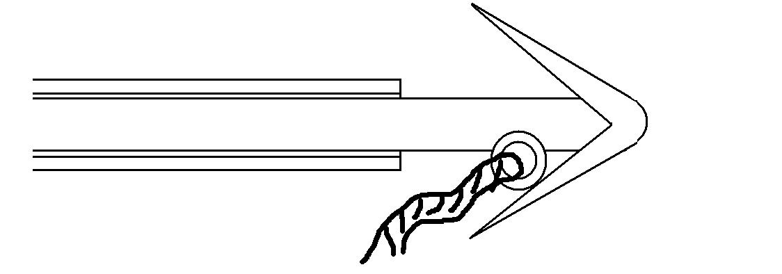

I'm going to try to get my hands on thin steel wire. My biggest problem right now is that the length of wire from the spool to the round inside the barrel is resulting in WAY too much slack. It tugs the wire way too hard, which snaps it.
I did this quick draw up to show you all what I'm doing right now.
I did two test firings yesterday straight up into the air and I literally lost one of the rounds because it flew SO high.
The next thing I want to figure out it what I should use for a "tip"
.. I wish I could put some sort of ampule on the end that would break on impact, and fill it with really sticky epoxy or something.
By the way... did I mention I'm using a Plastic Pellegrino bottle as an air tank?? 60 psi every time with no problem?? hahaha. (I'll eventually convert to a fire extinguisher tank when I build a serious version)
Thanks for all the input and concern!! And Sputnick no worries about hijacking, yours sounds pretty cool!!

Instead of rolling the wire on a roll, simply have it hang loosely on a pin, which points the same way as the barrel.
Then the wire can be pulled of more easily and faster, without having a roll to spin like crazy.
You can also put a bunch of wire in the barrel, in front of the projectile.
dont use the regular fishing line, go to walmart or dicks and get some gorilla line, it is braided line that goes up to 120lb test, that should definitley hold up, and will unwind way better than steelAegisAvenger wrote:Just wanted to do a teeny update!!

Or, you can just use the handle of a fishing poll, with reel already attached. They use a very clever mechanism, that you can never hope to manufacture your self, so why not just take advantage of their handywork? There is a reason you don't go fishing with a roll of fishing line taped to a stick. I am talking of course about fly fishing. I don't know about the other poles, but I would assume they function the same way.
