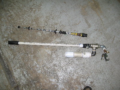

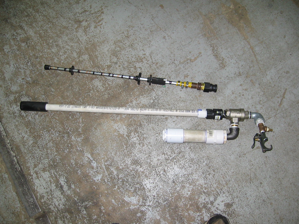

It's basically a parts gun, and YES the blowgun adapter is ghetto, but with a chamber this small, it's not a big issue...
It's a 1.5"x10" chamber attached to a 3/4" qev, piloted by your good old fashioned blowgun, with a 3/4" camlock for barrel swaps...
from 100 ft, it will put the blowdarts through oak 2x12 with 1 inch sticking out on the exit side, the 3/4" barrel will shoot nail type blowdarts through the same.
I've only got 2 barrels for this one, a blowdart barrel attached via garden hose to a npt to mht adapter and a 3/4" camlock. and a 3/4" barrel about 20" long to a camlock...
Can you tell I'm addicted to cam locks... there are some things they aren't suited for, but for this they work real well...

Very nice mate. Spare part guns are always the best ;) What pressure are you running through this little beauty?

Very nice for a spare parts gun (not that theres anything wrong with them).

I've run this up to 180psi... Sound's like a .22 firing the darts, and a 9mm when firing masrbles/bearings from the 3/4" barrel...
