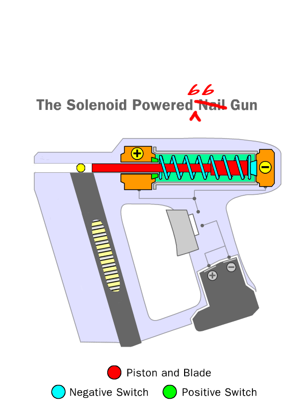

Jackie boy, seeing as how you brought the solenoid nail gun up, what about this for a solenoid gun?
I reckon if the solenoid is strong enough to drive a nail in it'd be strong enough to open a valve even against gas pressure which you'd get with this set up. The idea is that the inside of the solenoid is filled with pressurised gas (pale green/blue in the diag), it could be from a constant source like a compressor, or from a tank. Trigger the solenoid and the hollow bolts comes forward off the sealing face, allowing the pressurised gas to enter and drive the BB out the barrel. Release and it closes. simple hey?
OK, so you'd need some form of timing circuit for fully auto, but that's not that hard to work out surely? And this way, no need for a hammer valve at all.
Just a thought?
EDIT: Enlarge the image to get it to work properly.
Just a thought?
