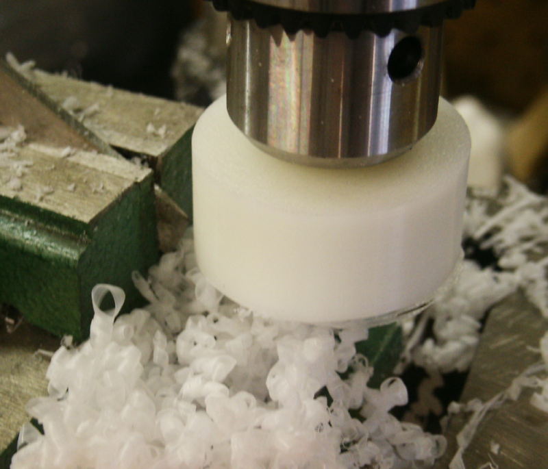

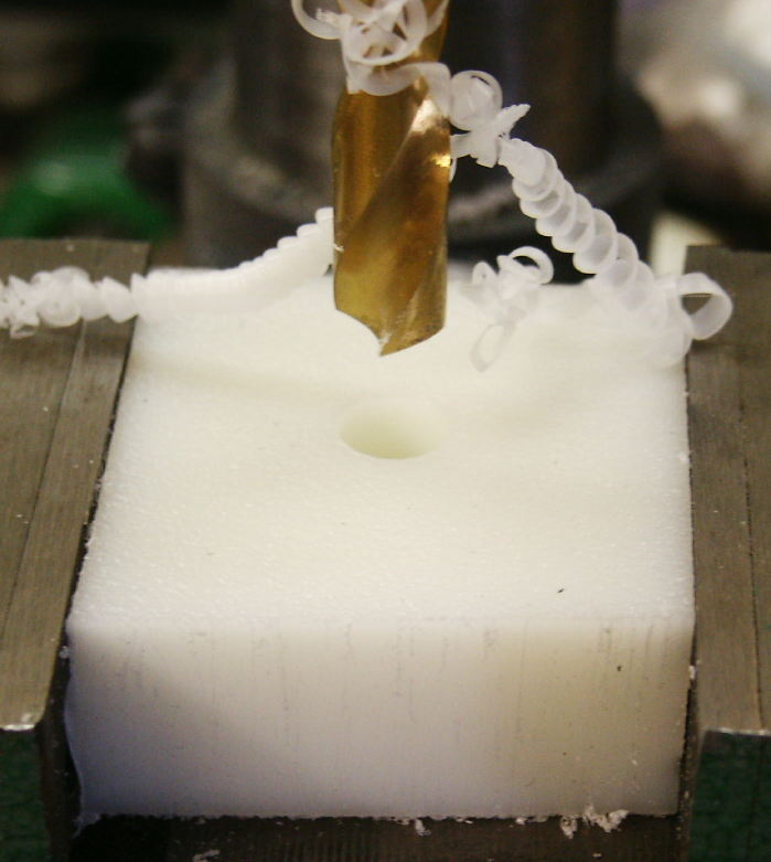

I didn't make a video and it would take too long when a couple simple pictures do the job.
I cut squares from the plastic and drilled a hole into, but not through it.
Then I screwed in a bolt with the head cut off and put it in the drill press chuck.
I used a wood chisel clamped in a vise as the tool to cut it round by lowering the chuck past the tool.
After it is round, a ground down chisel was used to cut into the sides to make the 2 grooves. Sorry I don't have a photo of cutting the grooves.
Tools used include;
A skill saw with fence to cut strips and then cut squares
A drill press
A Drill Press Vise
A set of wood chisels
A grinder to make a chisel very narrow
Digital Calipers to check everything for size.
