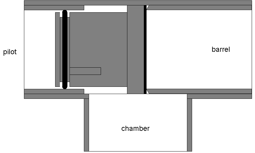

- is this perhaps what you had in mind?
- equal diameter piston and output.PNG (15.51 KiB) Viewed 5164 times
Could work, but only if you can size the piston properly.
This piston valve will open after the pilot volume has dropped to almost atmospheric pressure, when the pressure will leak into the porting as there is not enough pressure to seal anymore.
Without an O-ring or precise fit, this will dump a lot of air through the pilot before finally opening.
However, if you can prevent that, like with the o-ring. This "late opening valve" is also a very fast opening valve.

I don't see it opening at all as illustrated by iknowmy3tables, there simple is no pressure differential!psycix wrote:This piston valve will open after the pilot volume has dropped to almost atmospheric pressure.
It will dump the pilot and remain static.

but it's a sealing face and not a plug, therefore it needs to have a certain amount of pressure in the pilot to push the sealing face and make it seal

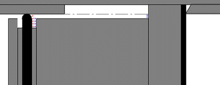

Regardless, if the piston rides in a tube that is the same diameter or smaller than the barrel, it will never open. Take a look at your design in detail and check the pressure vectors, it balances out so no net force on the piston. The most that can happen is that the rear o-ring flexes and pressure in the chamber leaks through the pilot.iknowmy3tables wrote:but it's a sealing face and not a plug, therefore it needs to have a certain amount of pressure in the pilot to push the sealing face and make it seal
- PISTONBALANCE.GIF (7.49 KiB) Viewed 4994 times

I intended to show that they were equal diameter, but I understandjackssmirkingrevenge wrote: Regardless, if the piston rides in a tube that is the same diameter or smaller than the barrel, it will never open. Take a look at your design in detail and check the pressure vectors, it balances out so no net force on the piston. The most that can happen is that the rear o-ring flexes and pressure in the chamber leaks through the pilot.
indeed they cancel out and there is no net force, and for the sealing face to seal there needs to be a positive force pushing the piston against the barrel. otherwise air will get through,
I know what you mean, normally there is some force difference from the pressure that helps the piston start moving, but in this case it's initiated by a "leak" of air through the sealing face that isn't sealing.
it's possible that if you used tough fixed non floating o-ring that were very tight there might be enough static friction to hold the sealing face in place, but I imagine typically something should yeild
