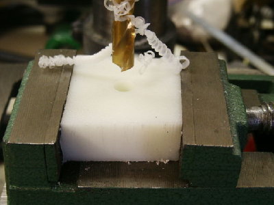

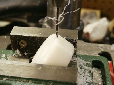

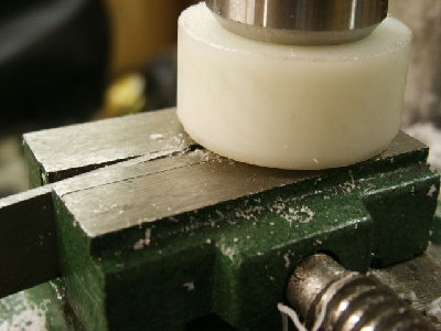

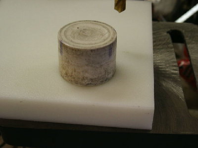

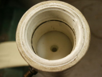

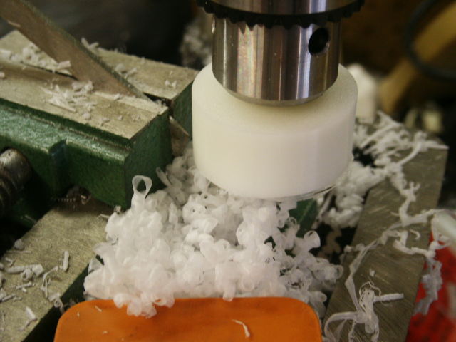

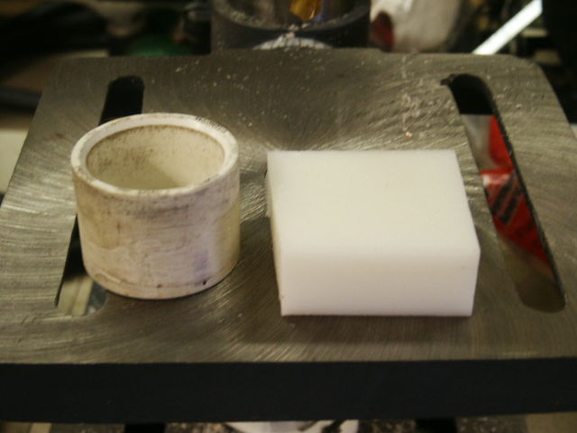

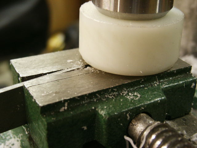

For smaller stuff, I have had excellent results using HDPE. It can be turned on a drill press to the correct diameter and then the face can be trimmed while on the drill press to create a true flat seal.
A short picture tutorial is below.
