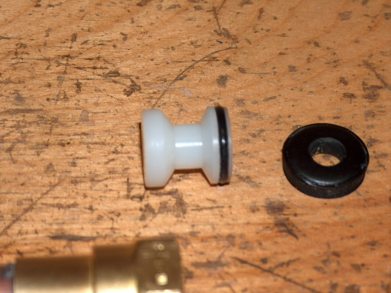

Thanks for letting me know about the DWV Tee, I was just following that instructables guide.
I reworked the piston and got it down to 1lb, 2oz. I think I can get it down even lower, I just need to borrow a 1" drill from work.
On a side note, I better replace that DWV elbow...
I'm trying to be safe with this, I thought(they weren't labeled at HD) those were sch 40. Anways, I am running a 50ft air hose out of the back, and I will split that at the end with a y, so I can remotely fill and fire this thing.

Hollowing the piston is fine, but you should seal off the hollow portion, or you will be increasing piloted volume.
It has that "familiar" look.
Sorry for all the questions everyone! I've made too many mistakes to redo anything else.Gippeto wrote:Hollowing the piston is fine, but you should seal off the hollow portion, or you will be increasing piloted volume.
Can I get away with using a pilot volume this large if I vent it with a 1" sprinkler valve? Or maybe I should use a 1" ball valve instead, the sprinkler might restrict the flow. Anyways, I need a large pilot volume to house the extra large bumper.
