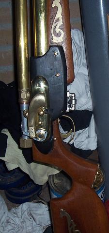

No vid, but a view of the latest improvement...and...a very nice embedded marble...

The hammer has been weighted with the aid of some lead, wich I hammered into the square hole in the hammerhead.
I also made the equalisation hole in the piston smaller by inserting an inner pen tube into it.Earlier I had stuck some tape over the hole, partially covering it, to get it to work.Offcourse that was no long term solution..The way I made it now it is!
It's now more powerful..I'll have to test the new max actuation pressure.
The number of shots went down by maybe 30%
Higher starting pressure should provide those lost shots back again in the upper region I couldn't get to earlier.
I also found out the hammer hit the bolt slightly wich prevented full out hammering..Fixed that too.
300 psi buries lead slugs into the same hardwood I made the stock from...
So...hopefully ( will test tomorrow) I'll get it actuating above 500 psi later!
