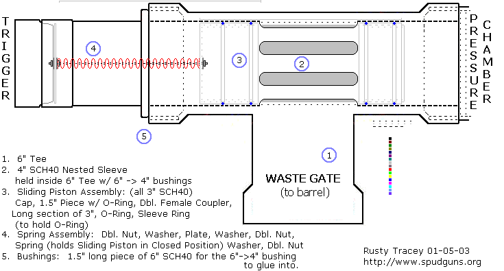

That form covers barrel sealer valves. Some piston valves have the inlet and outlet reversed. The Supah valve is one example of this. These chamber sealing valves are noted for controlled opening so they are less likely to break. The trade off is they are slower than a QEV style barrel sealer. The opening speed is completely at the mercy of the pilot valve speed and flow.jook13 wrote:http://www.spudfiles.com/forums/piston- ... t8157.html
If this thread still doesnt help for piston valves (you have to make it, in case you were not sure) I would suggest going to the store (an irrigation store, not lowes or home depot) and buying a 2 inch sprinkler valve. Even a 1 inch sprinkler would pack a descent punch with those rockets.
- Supah style valve showing the outlet off the side and the seal against the chamber.
- Quick_Valve_2.png (15.11 KiB) Viewed 4508 times
That forum thread has the chamber sealer as well. The only difference is it is shown as filling from the pilot side and it has a face seal vs. the o-ring seal againgst the chamber side. Its the concept.
