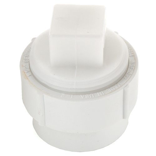

@ tech cleanout plugs only come in dwv and it looks like that is what to used for the back i only said that because i have had cleanouts fail for my piston gun when i first made it thats why i switched to screws also i am including my bumper in the opening so it will be opening 1 1/2inches but only when it fully compresses the bumper my bumper will be 1/2 inch neoprene sheet which i'm sure will do well at shock absorbtion.

spudtyrrant wrote:@ tech cleanout plugs only come in dwv and it looks like that is what to used for the back i only said that because i have had cleanouts fail for my piston gun when i first made it thats why i switched to screws also i am including my bumper in the opening so it will be opening 1 1/2inches but only when it fully compresses the bumper my bumper will be 1/2 inch neoprene sheet which i'm sure will do well at shock absorbtion.
It is possible the plug on the Mouse Musket is a clean out. It's so old, I don't remember what the part was labeled, but it appears to be as heavy as the rest of the Sched 40 parts. The rest of the cannon is Sched 40. It never had a plug failure, only 4 piston failures. The female adapter is double layer, inserted fully inside 2 inch chamber.
The plug on the ABS cannon is a clean out plug. The female adapter and plug was originally PVC. They were replaced. It was originally PVC for strength. The female adapter shattered and the piston launched onto my foot. The current configuration of all ABS has not failed.
Edit; Google is your friend. SCHEDULE 40 PVC pipe plugs are for sale
This is the part I have. The clean out plugs have a square end for the wrench. The Sched 40 parts are this shape. The Mouse Musket does have a Schedule 40 plug.
PVC Clean out.  I don't use these in PVC.
