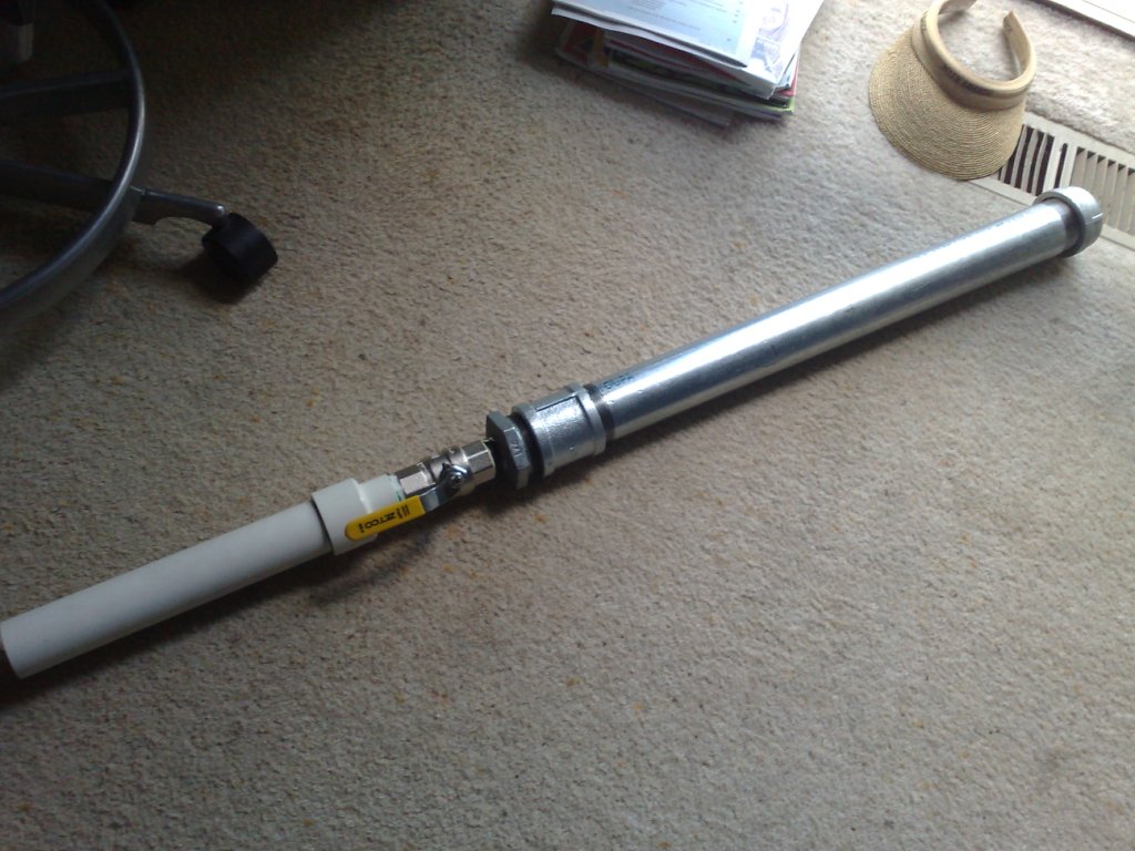

I'm back with more of my dry icing.
After building a PVC dry ice cannon, http://www.spudfiles.com/forums/viewtop ... tml#243398, i decided that continuing with PVC was too dangerous, due to the temperature sensitive nature of PVC.
So i made one out of galvenised iron! Cost me a total of $80AU.
Its just a length of pipe with a cap on one end and a ball valve on the other. Dry ice goes in through the ball valve. I seal it, then dip the end in near boiling water. The ice sublimes.

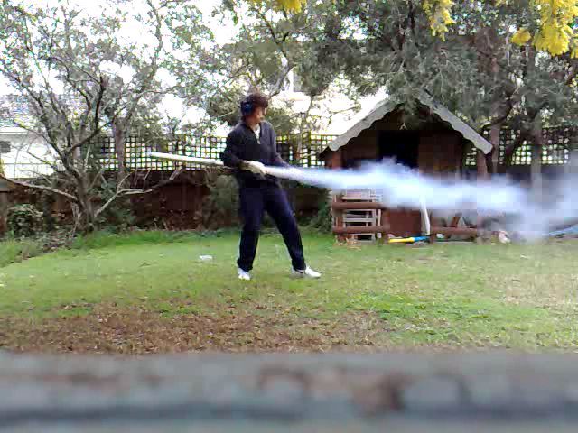

The cannon alone weighs 5kg. I attempted to fire it horizontally like a gun. Shot back like a rocket about 10m. Left me with a nice bruise on my hip. Its like a damn rocket.

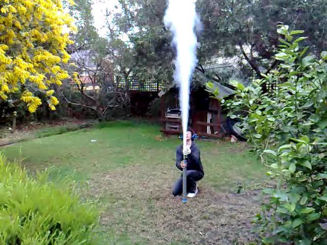

Vertically, i'm shooting small potatoes up in the air. From firing to hitting the ground is about 8-9 seconds. So i'm estimating about 50m up in the air.
In hindsight i probably should have used a smaller chamber. It would use less dry ice and there would be less recoil (and less rocketlike behaviour). I still love it. I think the ball valve might be beginning to fail though. Its becoming very loose to turn. It's only rated for 200PSI and I estimate im reaching a lot more than that.
Any suggestions would be great.
the cannon
the cannon
horizontal. bad move. you can see it pushing out of my hands
Vertical
Vertical

It must be pretty entertaining to shoot, but it could definitely be improved.
A longer, smaller bore copper barrel launching heavier rounds would improve efficiency over the current version (which is actually shooting about 100m in the air, equating to a muzzle speed of about 50m/s). A pressure gauge would be a really good idea as well, especially with that PVC barrel - it might not burst, but I wouldn't trust it. If you'd rather that it stay large-bore, a PP or ABS barrel would be safer. Either way, the barrel needs to be longer.
The recoil issue would certainly be solved by using less dry ice. As is, your propellant gas probably weighs more than your projectile :lol:

How about a burst disk between the valve and the barrel, to give you a bit of a delay to let you have full flow before your projectile starts moving.
Also, given the relatively slow opening valve, that tiny barrel isn't doing you any favours either. It should be at least 4 times as long, you'll get a significant increase in power and less muzzle noise to boot.
