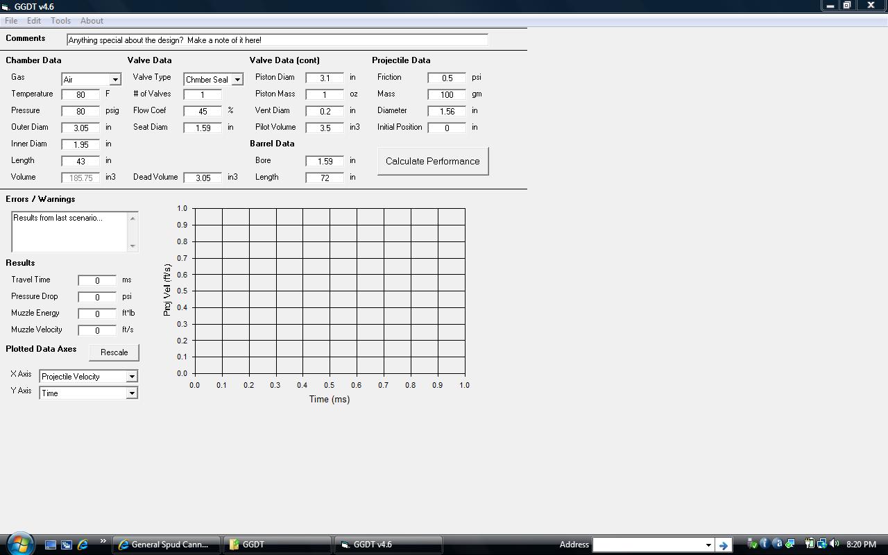

hello ive recently downloaded the ggdt and am wondering if i could get some help with filling in the blanks
ive attached a picture for refrence
in the chamber data colum its pretty straight forward only problem being i dont know the temp of the air im putting into the chamber???
any ideas???
in the second colum *(valve data)* it asks for what type of vavle im using but ball valve is not there????
also the flow coefient????? seat diameter??????? dead volume??????
im using a basic 1" ball valve?
i have other question but ill ask as the questions are answer,,any help is gratly appriciated

FORE!!!! wrote:forward only problem being i dont know the temp of the air im putting into the chamber???
Leave it as it is, room temperature.
Change valve type to "generic"
Flow coef around 35
Opening time - well, depends how fast you can open it really. I would say around 100ms to give you an idea.
frozebyte
Posts: 136
Joined: Wed Jun 24, 2009 7:22 am
Is there even a box for opening time? :]
Dead volume is the amount of space between main valve and projectile :D
Hope it helps and if im even correct.
Cheers.
Has thanked: 581 times
frozebyte wrote:Is there even a box for opening time?
If you change the valve type to "Generic" then yes.
That you are.

wow changing it to "generic" made things alot easier lol
now for the projectile colum, friction??? initial position????
im using everyday marbles

it asks for an answer in inches cubed for the dead volume, my marble rest againt the internal ball from the ball valve so the is no dead volume???
FORE!!!! wrote:now for the projectile colum, friction??? initial position????
Leave friction as it is, intitial position and dead volume are zero if the projectile is resting against the valve.

ok its come up with a warning that the barrel is choking the flow,,can some one kindly tell me if i should bother with this warning???
my ballistic range is 245m and takes 7 seconds to reach is that respectable???
muzzle velocity 156.6 m/s
muzzle energy 78.5 j
travel time 12.5 ms
pressure drop 0.4 psi
how am i doing ???????? is this a decent gun???? for what it is???

FORE!!!! wrote:pressure drop 0.4 psi
How big is your chamber :shock:
Can you post a screen cap?
It just means your flow coefficient is too big but this doesn't affect the results.

it 65mm pipe approximatly 1.1 m long

That's yours. GGDT tells me I get 955 feet per second at 156.3 ft/lbs. From a 5g projectile.. And then if I use hydrogen, 1449 feet per second at 360 ft/lbs.. Ahh, 400 psi with a super efficient piston valve ported b a 1/2" QEV..what Won't you do? ( next gun)
It will go up or down depending on how fast you open the valve. I put in 200ms as a starting point. Spring loading would definitely give moar.
