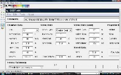

hello ive recently downloaded the ggdt and am wondering if i could get some help with filling in the blanks
ive attached a picture for refrence
in the chamber data colum its pretty straight forward only problem being i dont know the temp of the air im putting into the chamber???
any ideas???
in the second colum *(valve data)* it asks for what type of vavle im using but ball valve is not there????
also the flow coefient????? seat diameter??????? dead volume??????
im using a basic 1" ball valve?
i have other question but ill ask as the questions are answer,,any help is gratly appriciated
ggdt HELP

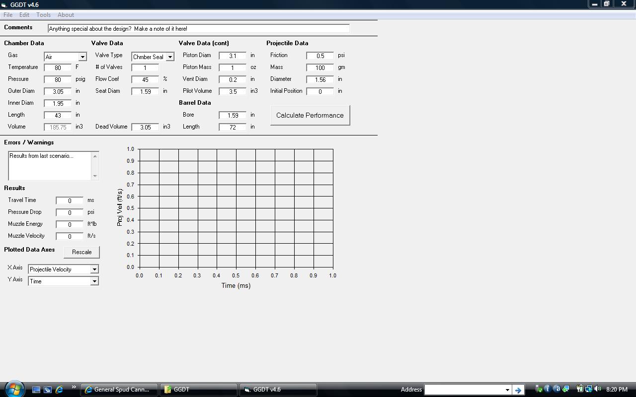

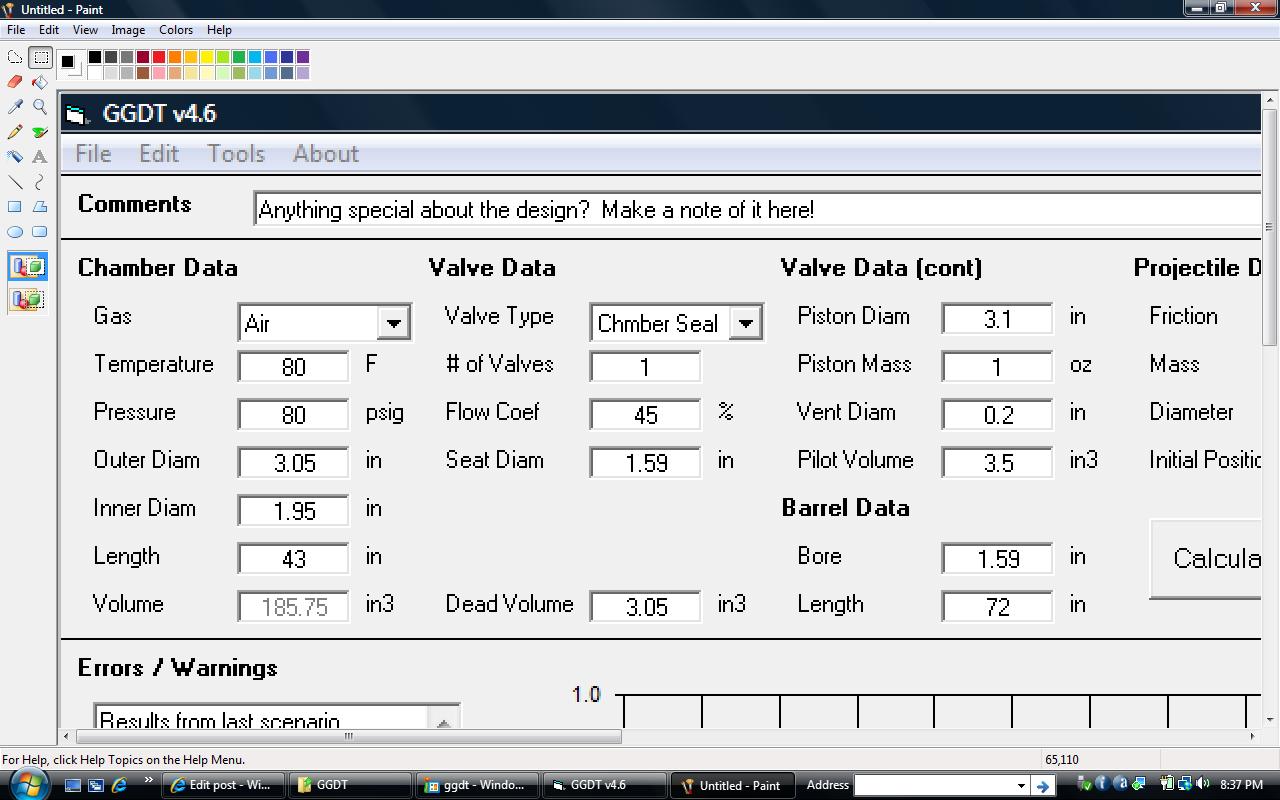

How big is your chamberFORE!!!! wrote:pressure drop 0.4 psi
Can you post a screen cap?
ok its come up with a warning that the barrel is choking the flow,,can some one kindly tell me if i should bother with this warning???
It just means your flow coefficient is too big but this doesn't affect the results.
