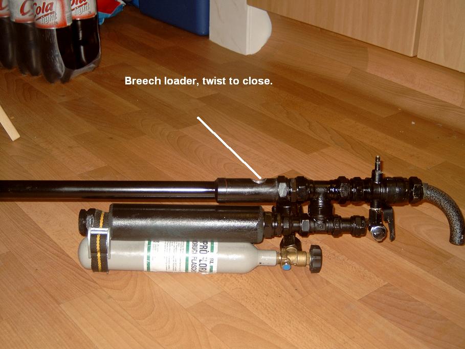

Second I have added a breech loader,
the kind with a hole in the top and a rotating pipe to seal the hole.TH hole is so tight the marble has to be "clicked"in .From the hole I can push the marble all the way "home" for optimal use of barrel length.

I can now open a valve ( a chrome one yess!!), twist the breech, pop in a 1" marble and fire!!

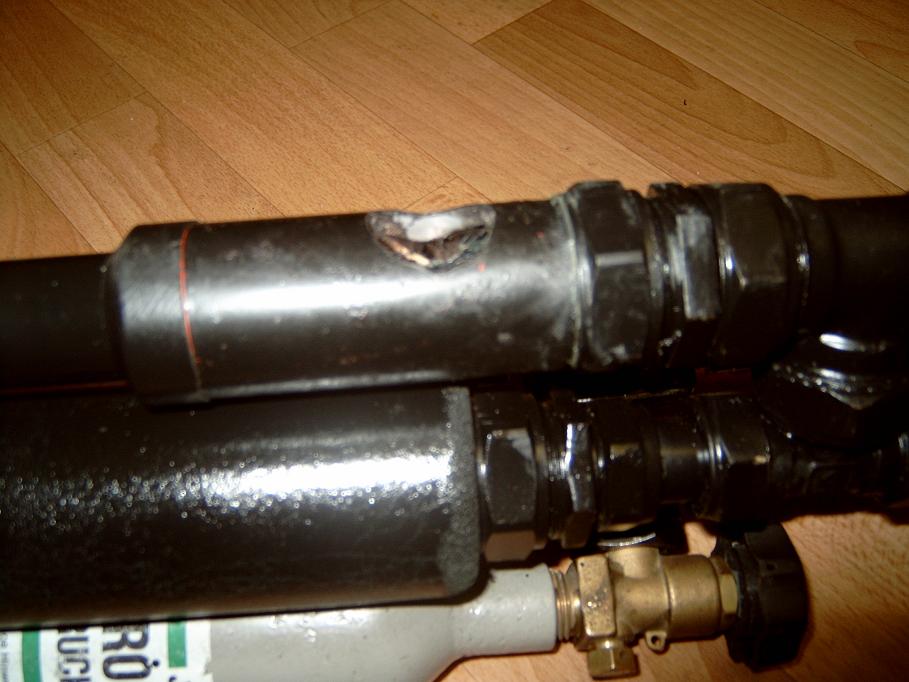

View from the right
View from the right

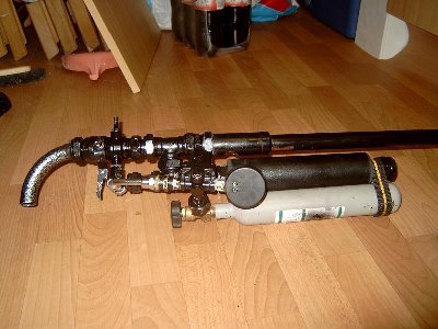

Close up of CO2 (350 gram)bottle.I will put a black sock over it , but left it like this for the pic.
View from the left.
View from the left.
breech close up
breech close up

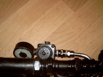

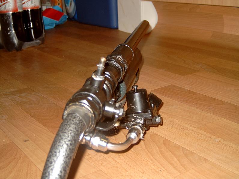

Reg close up.Gauge ( 25 bar) fitted into reg.

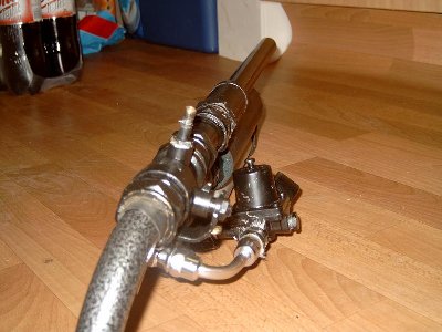

view from the rear.You can see the regulator on the side.

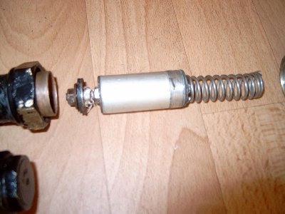

the piston and it's spring.

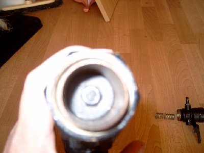

piston inside of disassembled gun
inside of the piston housing.Not much too look at really.Maybe you can just make out the sealing port.
