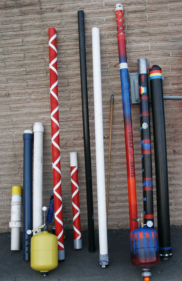

I prefer a variety of screw on barrels. It's a waste of a mauler to not have at least a golf ball barrel.jonnyboy wrote:Look around the showcase, different people have different tastes in what looks good to them.

Oh I love your multitude of barrels tech
May I ask how you did the gradient looking paintjob on the barrel left of the right tank?
- Technician1002
- Posts: 5189
Sure. Spray paint. Used orange, red, cherry red, and two shades of blue. I rolled the pipe to paint around it and then switched colors lightly overspraying the prior wet coat just enough to not have a light or dark transition in color.jonnyboy wrote:Oh I love your multitude of barrels techMay I ask how you did the gradient looking paintjob on the barrel left of the right tank?
The bummer is we modeled the 2.5 inch barrel as the best performer in GGDT so I painted it to look pro, then in testing the 3 inch black abs with the grey tip (totaly screwed chrome paint job) performed the best. I should have clocked them all before doing a nice paint job. I lettered it Cheap seat Shots since we were aiming for the cheap seats.
The blue 3 inch next to the yellow launcher is the one they used in the competition. They painted it, put in the muzzle brake holes, and added vinyl graphics that looked very sharp.
They went a little shorter than the most efficient length for ease of handling. They came up with the support strap and breech loader shown in the video. Since most of the acceleration is in the first third of an optimum barrel, they lost little performance cutting off almost 2 feet from ideal. For best distance, it would have been the length of the grey tip black barrel with the blue and red trim. They did a fantastic job.
The shorter barrel was louder.. Which everyone liked..
