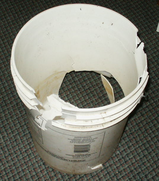

At high velocities it doesn't hold up.. Attached is the results of using a carpet over a sawhorse to catch a rolled up t shirt. This was subsonic at just under 400 FPS. It went right through 2 layers of carpet. The carpet over the sawhorse provided a double layer. It went through both layers. Projectile is about 5.6 oz in weight.Big-E wrote:A big piece of carpeting or multiple layers of heavy material (canvas, heavy dropcloth, etc) make for a great backstop. you must have a means of suspending the material. I use the frame from an old swingset that my kids don't use anymore in my backyard.

The carpet was draped over the sawhorse. The sawhorse behind it was there to brace it. The impact broke off 2 legs of the rear sawhorse and knocked the front sawhorse over. The shirt continued and hit the bucket in the background that is against sandbags.Big-E wrote:Hence why I said it works for most pneumatics... if you are using a bigger projectile, or high pressure (like most big PCP rifles) it probably won't work well. since he's shooting marbles, it will probably work ok. it works fine for me.

I used the carpet to protect the bucket as it was getting beat to death.

The sandbags worked well, but were becoming a pile of sand as the bags broke.Big-E wrote:You sir, definitely should have used an earthen backstop![]()
I take it the t-shirt was rolled up and rubber banded.
For reloading and re testing, instead of rubber bands, I tied it with mason line.
Behind the sandbags is the woodpile. I didn't get any through that. I did have one ricochet and fly over the fence into the neighbors yard. I didn't always hit the bucket dead center..
