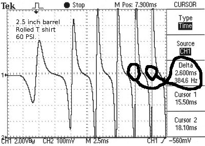

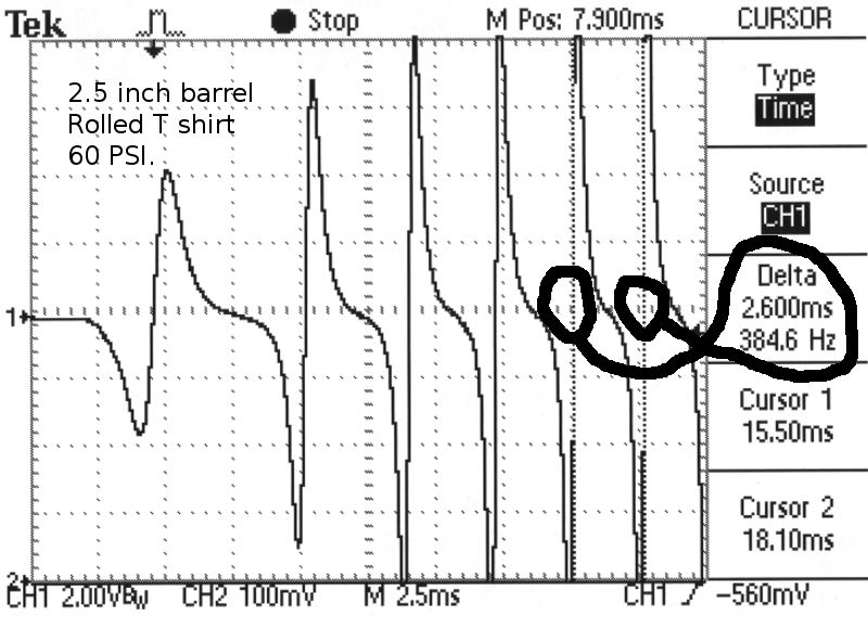

At high velocities it doesn't hold up.. Attached is the results of using a carpet over a sawhorse to catch a rolled up t shirt. This was subsonic at just under 400 FPS. It went right through 2 layers of carpet. The carpet over the sawhorse provided a double layer. It went through both layers. Projectile is about 5.6 oz in weight.
Oops shot data.  The last coil is off the scale on the right.  The last foot measured has a travel time of 2.6 ms for an average speed for that foot of 384.6 FPS.  It was still gaining speed.
Last edited by Technician1002 on Wed Jul 29, 2009 12:21 pm, edited 1 time in total.

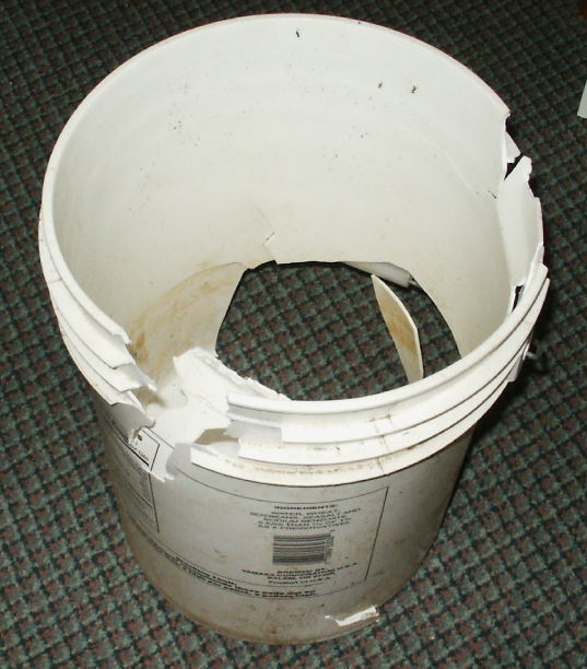

The carpet was draped over the sawhorse. The sawhorse behind it was there to brace it. The impact broke off 2 legs of the rear sawhorse and knocked the front sawhorse over. The shirt continued and hit the bucket in the background that is against sandbags.
I used the carpet to protect the bucket as it was getting beat to death.
The bucket after the end of testing.

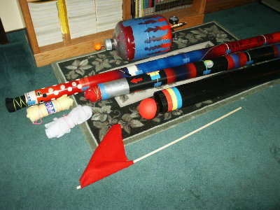

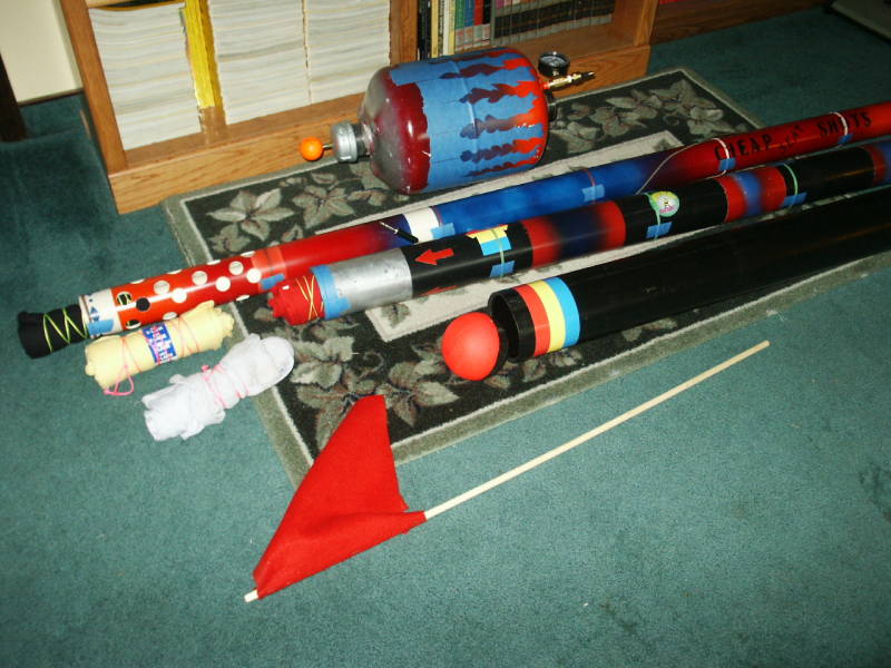

Shirts and tubes for  a day of testing.  The two back barrels are wired with pick up coils.  The 4 inch in front has the coils removed.  It was tested first.

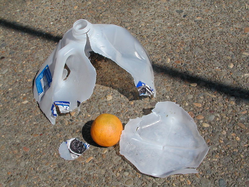

Milk jug full of water hit with an orange.

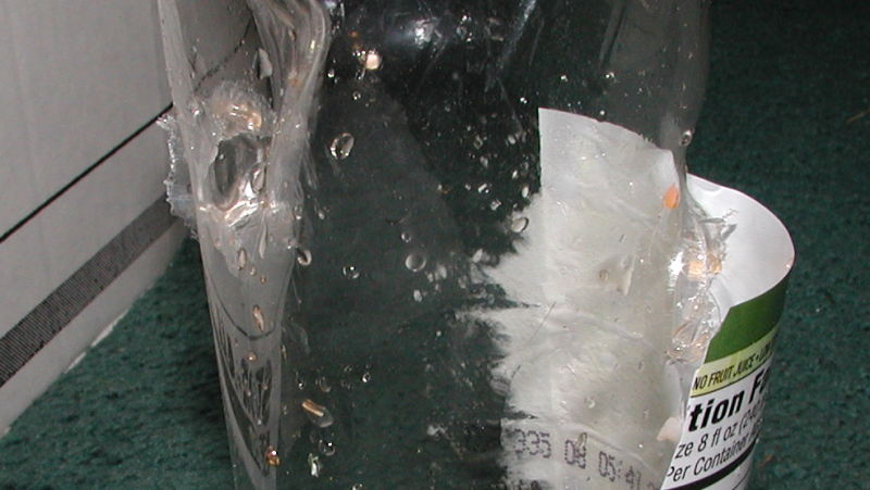

Jawbreaker was slowed some as it went through this bottle filled with water.
