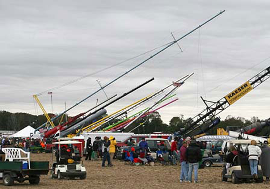

Another interesting thing I noticed when reviewing videos this weekend, is that they seem to be firing at more than optimal angles, 45+ degrees, which may be because there are serious air currents at 600+ft..., or maybe they subscribe to the fallacy that 45 degrees is the best angle...
- Technician1002
- Posts: 5189
This is most likely an illusion. Many shots from behind the cannons make the barrel angle appear higher than it really is. Keep looking. Find photos taken directly down the line of fire. They are way under 45 degrees.jeepkahn wrote: Another interesting thing I noticed when reviewing videos this weekend, is that they seem to be firing at more than optimal angles, 45+ degrees, which may be because there are serious air currents at 600+ft..., or maybe they subscribe to the fallacy that 45 degrees is the best angle...
Shots from behind and with telephoto to try to catch just the pumpkin and muzzle blast will appear to be nearly straight up.
Last edited by Technician1002 on Wed Aug 05, 2009 5:19 am, edited 2 times in total.
Although possible, that's only of use if the currents are in the right direction.jeepkahn wrote:... which may be because there are serious air currents at 600+ft...
However, air does reduce in density with altitude, reducing drag somewhat. This can actually make ideal launch angles in excess of 45 degrees exist, however, it only really occurs at very high altitudes.
Mostly it just nudges up the ideal launch angle a tiny fraction over what it is if modelled with air of fixed density.
