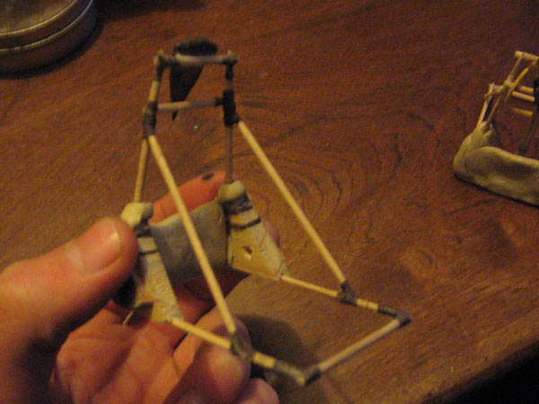

Here are some pics of my miny toothpic terrors.Made with toothpics,thread,putty,wood and wood glue.If you ever get bored than make these,they hurl peanuts 30feet.I haven't built a big one but I might when I get my arc welder.The concept is simple.
