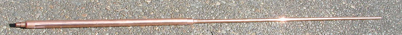

My plan is to use barrel inserts like this:
Comments, suggestions?

The 3/4 > 1/2 fitting reducer edge could be made thicker by soldering a 1/4" length of 1/2" copper tubing and smoothing the edge. Agree?
The barrel insert uses an O ring piston epoxied to the copper.
Should the hose clamps slip I can use several other designs to hold the insert with greater force.
