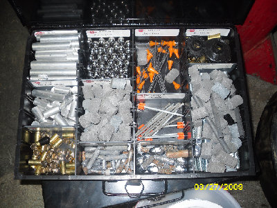

jeepkahn
Posts: 747
Location: Triad, NC, USA
Call your local hardware store and ask for powder actuated fasteners...
They are hardened steel, and are used for attaching to steel I-beams and such...
The fins are actually collars designed to hold the nail centered/true in the barrel of a powder actuated nail gun...
you can see the ones I use in this pic of one of my ammo organizers...
