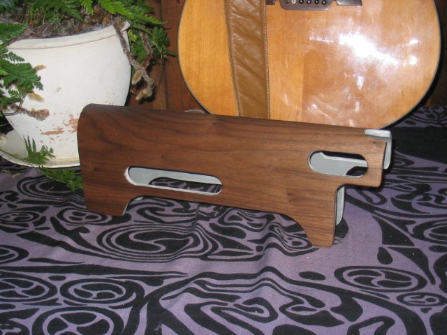

I'm working on a 7 shot semi-auto revolver type 40mm grenade launcher. I've got the body and main air complete but still need to start work on the trigger assembly and mount the control air devices. At 32 inches long and around 18 pounds unloaded it's designed to be carried and maneuverable. Testing so far is favorable.
Below are some pics of the stock before and after finishing. The stock is made from PVC sch 40 electric conduit that I heated in the oven then pressed to shape over a 2x6 with a piece of pipe resting on top. Cut out was done with a hacksaw blade and hole saw. The walnut veneer is finished with 3&1 oil since that’s the oil I carry with my when I shoot. The inside of the stock wil be painted flat black.
I'll post a before and after of the gun once I apply the finishes to the gun body.

Wow, Well done for a PVC construction. How hot was the oven to soften the pipe?
Wow, that looks nice, how did you make that stock look like actual wood? What kind of finnish did you use?

It is real walnut. There is a self- adhesive backing with a peal off liner. The finish is with oil.

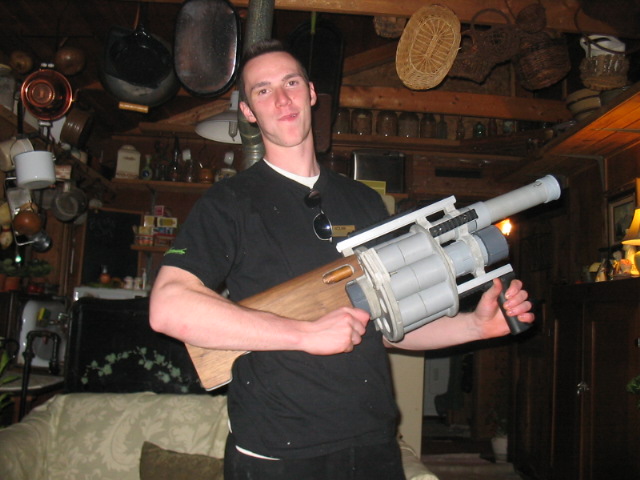

any chance to see pics of the whole gun ?? how does it work?
The gun is modeled after the Milkor MGL-140.
http://www.milkorusainc.com/gallery.html
It's to early to show as I still have the trigger and air control circuit to install. The pic below is the body and main air. Once complete I'll gladly post more details on its construction and how it was made along with credits to those persons who's idea's were incorporated into the design.
The body is made almost completely out of SCH 40 PVC electric conduit as it is easy to shape. The pressure camber is SCH 80 pressure pipe with the balance of the pressure pipe being copper. The cylinder is operated by an air piston. I'll get into more details if requested when construction is completed. I intend to post detailed photos of the disassembled components along with the finished product. About 3 weeks since I'm leaving on vacation soon.
The concept was to construct the gun using common hardware parts with basic hand and power tools. I used a drill and a hacksaw.

Is there some sort of reloading mechanism? I assume that the chamber won't pop out similarly to the real thing due to the air tank, but do you have any other ideas? What do you plan on using for ammunition?
Also what were the dimensions of the electrical conduit you used for the stock?

Awaited eagerly.I'll get into more details if requested when construction is completed. I intend to post detailed photos of the disassembled components along with the finished product.
Attached is a 2d drawing of the cylinder advance and loading plate. The plate rides on the back of the cylinder and rotates 1/7 of a turn with each shot. The tab on the right contains a spring and roller that locks into groves cut into the cylinder in clockwise motion only. The tab on the left is the loading port. Side the tab out to remove or load the ammo. The cylinder advance is driven by an air piston made from 1/2" and 3/4" copper pipe. When the air chamber is charged the piston advances the plate one step. When the gun is fired the plate is pulled back by a spring ready to repeat the cycle again. The frown looking cut out above where the plate slides over the air chamber is most important of all. It provides passage for a rod connected to the trigger and provides the final line up of the cylinder to the barrel. If the cylinder is not aligned to with-in 1/32" the gun will not fire. There is a manual 3-way valve by the trigger hand thumb that will manually advance the cylinder allowing you to use a variety of ammo and pick which ammo to use on a given shot. By opening the ammo door and pointing the gun up, you can use the manual advance to eject the cartridges from the cylinder. I've tested all the components and they work a designed but have yet to put them all together on the gun at once as I'm still working on the trigger mechanism. Once this is done I'll break down the gun prior to painting and photo it. I believe this photo along with a brief narrative and credit links will provide all the info one needs for construction. About 3 weeks.
The ammo is a cartridge. I've tested them and they scream. I'll post separately on the ammo. They are made with a piece of 1 1/2" pvc and bushings cut from an 1 1/2" and 1" coupling. Both ends are sealed with foam.
