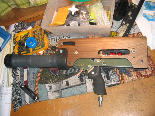

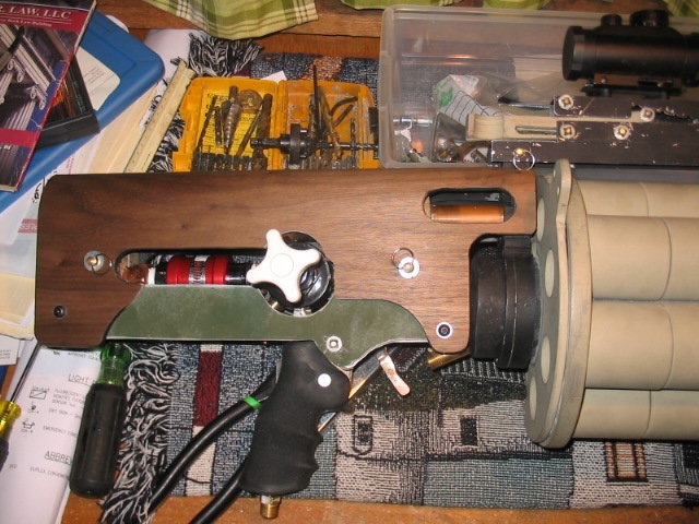

I managed to install the trigger today. Below is a pic of the power works. The 1/4" nipple to the right of the trigger is where the contol air is going to tap in.

Below is with the stock on. The power air set up is from a post by PCGUY featuring the use of a slider valve for semi operation.
http://www.spudfiles.com/forums/viewtopic.php?t=160

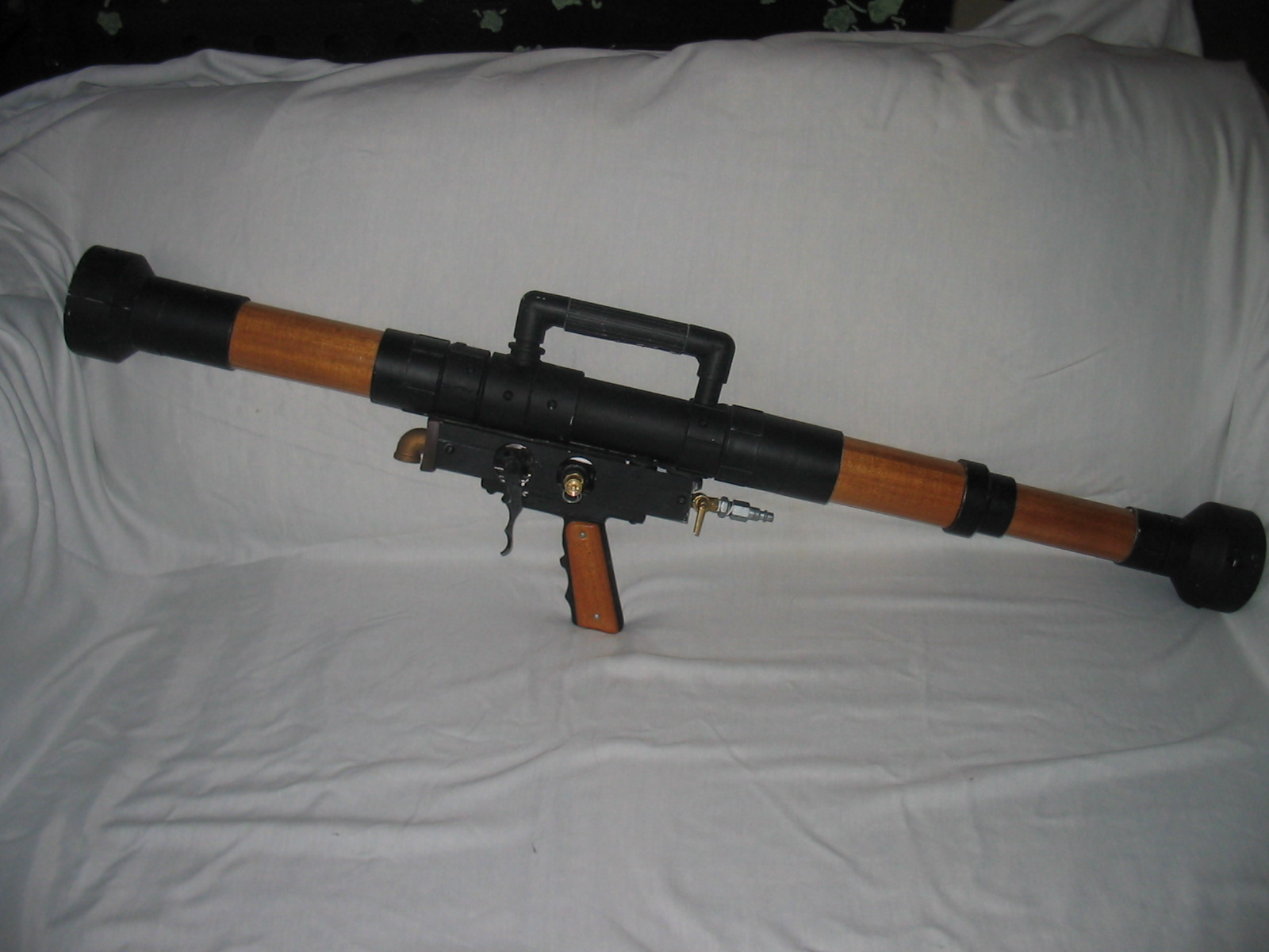

Since this thread is already started I thought of using it as a construction log of my gun in order to receive advice from advance builders or as a guide for others.
Before continuing any further with the MGL, I decided to take the power pack for a test ride and check for leaks. We shot about 250 rounds of assorted goodies from paintballs to bolts. I made a couple of adjustments in the process but overall there where impressive results. Shots where made using the 4" stub from the piston port as well as with a 30" piece of 3/4' copper.
Test pressure was 120psi and using a 3/4" barrel with an air chamber sized for 1 1/2" made for some rather large air blasts out of the muzzle. The adjustable piston worked very well and is very much lighter then the last one I built. My chrono only goes to 1000 fps and it was pegging from the air blasts. Moving back 15' I began to get good readings. Even at 10' the blast affected the chrono. Consistency surprised me with shots reading 560 fps +- only 2 fps for all shots. We clocked about 30 rounds.
The gun is modular in construction and has gads of adjustments. Adjustments include:
Chamber pressure from 0-300 psi
Pop valve from 25-300 psi
Trigger travel 5/8-1"
Trigger pull weight light-heavy
Piston equalization size 0-1/8"
Chamber fill port size 0-3/16"
Piston travel 0-1 1/4"
Chamber volume small-unlimited
Barrel length 4"-unlimted
Barrel diameter 1/8"-2"
There is also a pneumatic control circuit to allow for auto or manual chamber advance or whatever else it may be called upon to be used as. It becomes pressurized on chamber fill and empties on trigger pull or can be controlled manually by the small 3-way valve button just above and behind the fore grip.
I made the power pack so adjustable and modular because I really don't know what I'm doing and wanted to be able to make corrections. The revolver portion of the gun only takes a few minutes to remove or install from the power pack. It just threads on to the air chamber. With the tests coming out so well I plan on using the same power pack for the MGL, a submachine gun, stationary connon and a long range sniper. The air chamber is threaded on so I can reduce or enlarge the size to a more appropriate length for the application. Using the same power pack for a variety of guns will cut both construction times and costs.
