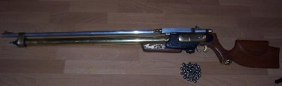

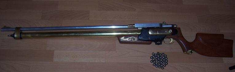

Yesterday I finished a new barrel for this one. I found 35 ballbearings ( hard steel!) with a diameter of exactly 16 mm wich just wouldn't fit the old one.
Upside is I could do some things differently now.
The barrel is 15 cm longer than the ( sleeved) old one.
I no longer sleeved it because I simply polished the aluminium barrel for looks.
So the frontheavy-ness is mostly gone too as the sleeve was a big factor.
I also prepared the breech to accept magazine fed action.
This tubemag, currently under construction will run aside the barrel on the left side of the gun.
So it will be...cocking the hammer *while slipping my hands onto the bolt *handle..click clack..and boom!
Repeat if necessary
I also added some rubber rings around the bolt to make the action quieter ( bumper) and keep some pressure on the bolt in sealed position so it won't open accidentally.The rubber washer helps to keep it locked.It is not envolved in the actual seal.
So...it's all details now..

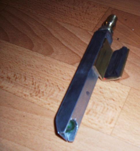

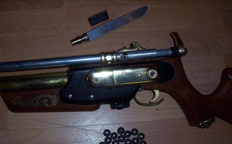

Detachable 5 shot magazine is working!
I still have to finish it, smoothen some of the corners..that kinda stuff.
But amazingly it works! I couldn't figure out how to mount it...but things just started to happen so to speak.
It is held firmly in place by a bracket with some rubber to keep it holding on tight.
The only spring I had that could do the job regretfully could only be used to load 5 balls.
With one in the " chamber" this means I can still do all of the good shots...before power goes down too much.
I can slip off the mag easily and just breechload by hand.

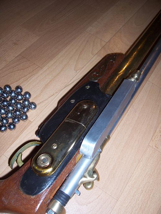

Until recently I've mostly shown the hammer side of the gun..now this side has some interesting features of it's own..
A little peek from a different angle.<br />Tried to keep it as low profile as possible.It might need a small brass ornament to &amp;quot; break&amp;quot; the squared look though.<br />You can see a small portion of the hammer over on the right side..I can now cock it and work the bolt in a single move..and get up to 6 shots in a short timeframe.
Tried to keep it as low profile as possible.It might need a small brass ornament to &quot; break&quot; the squared look though.
so proud right now..Notice the rubber washers on the bolt wich help to keep it locked and work as a bumper for the action.
You can see the marble inside wich is glued to the magspring.The only way to push out the last BB.<br />The bracket slides in between the barrel and chamber and locks in position between the black sideplates of the body.
Last edited by Brian the brain on Sun Nov 08, 2009 3:50 pm, edited 1 time in total.

First I will add another small bracket so the tip can't move away from the breech.Some type of thing on the body itself for the mag to slide into..
It can wobble a bit now and I don't want it to. A simple fix, but I still need to do it.
