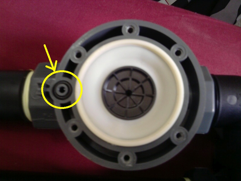

It could be possible the port that went through the electric pilot valve is leaking. Did you seal up the original pilot port? It vents into the barrel.jmadden91 wrote:Cheers mate, Ill look into it. I can pump up however high I want, it just leaks fasterlol
Edit: As to how its leaking, it just comes out the barrel lol. Like the diaphragm just doesnt make a proper seal
- Technician1002
- Posts: 5189
That's the one. You are down to finding the damage to the diaphragm or valve seat. Something is keeping it open. Check the flow direction. When reversed they won't seal either.jmadden91 wrote:Do you mean this port tech? If so, no I haven't
Edit: Sealed, tested, same problem

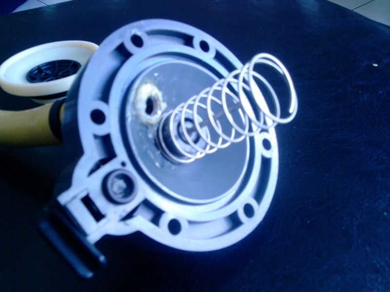

@grock, it does have a guide rod, where abouts did you fill with hot glue?
Thanks again guys its driving me mental lol. It was mind you, the cheapest in the store. Is it possible it will make a seal with water but not with air?
Best thing to do with the guide rod is to leave it alone. It is there for a reason and does not require any modifications.
You say you can hold your hand over the barrel and pressure will build up. If you allow the pressure to build up, will the diaphragm stay closed? If so, you should try some of the suggestions I mentioned above (move the schrader, drop the bike pump). If that doesn't work for you, then you probably have a faulty valve/diaphragm. And if that is the case, let it be a lesson to you: Next time, go for quality.
