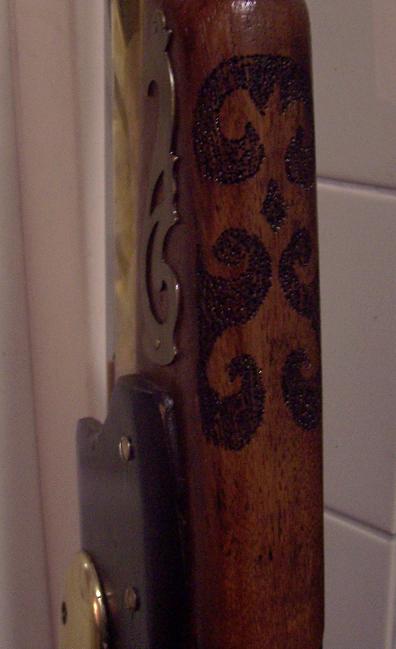

As this is still a build log:
I made a buttpad for it and decorated the foregrip...

More updates:
Added sling and finished front grip checkering.
Couldn't use the focus button as no flash means no picture at night...
Just to give you an idea:
