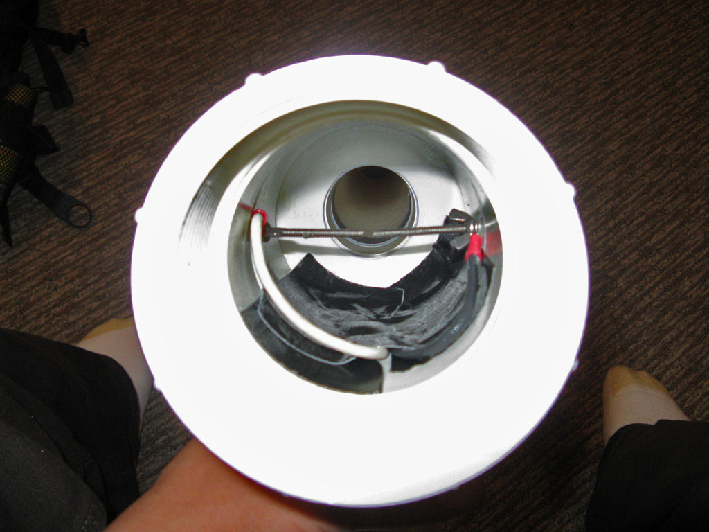

- 3x3x1.5in Sanitary 'T'
- 3in clean-out adapter
- 3in plug
- 3in to 1.5in reducer bushing
- 1.5in female thread adapter
- 1.5in terminal adapter (the gray one, it's electrical PVC, it has a deeper female smooth area for better glue hold on barrel)
- 1.5x21.75in thinwall PVC pipe (160psi rating)
- 1.5 pipe about 1.5in long to connect the 'T' to a male thread adapter
- 1.5in threaded cap w/BBQ ignitor
- Gorilla Duct Tape to cover the 'T' hole

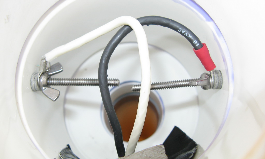

Chamber is about 6.5~7.25in deep, depending on if you measure from the 3" plugs square hole or not. So I averaged it to be 7in long. Using burnt latke calcs, I guessed it's about 834 ml in volume, so I would need a 21.75in length of 1.5in 'thinwall' pipe, for a 1:1 ratio.
I use the Weber Ignitors, drill a 19/32 hole in a PVC threaded cap and glue it in place with PVC glue and some hot glue for extra help.
I then drill (7/64in) & tap (#6-32) two holes in my chamber, and find correct length of #6-32 stainless steel screws for the gap. Use a #6-32 locking washer & wing nut to secure the BBQ wires to the screws inside the chamber. I finish it up with screw covers.

Had some ignition issues, so I put some PTFE tape on the very top of the screws where they are in contact with the PVC, and widened the gap about 1mm on each side. So far the dry firing is working 100%.
edit: the extra PTFE tape didn't fix my issues. I seem to be getting sparks up behind the Gorilla Tape.

I widened the gap just slightly, about 4~5mm gap now. I think I've solved my spark issues.
I got some fiber washers on the inside of the chamber, then the ring terminal, then lock washer & wing nut. Before the ring terminal was in contact with the chamber wall.
I've done 40+ dry fires, and they all sparked between the screws.
