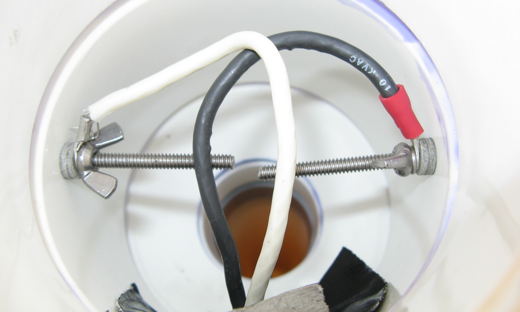

I then drill (7/64in) & tap (#6-32) two holes in my chamber, and find correct length of #6-32 stainless steel screws for the gap. Use a #6-32 locking washer & wing nut to secure the BBQ wires to the screws inside the chamber. I finish it up with screw covers.

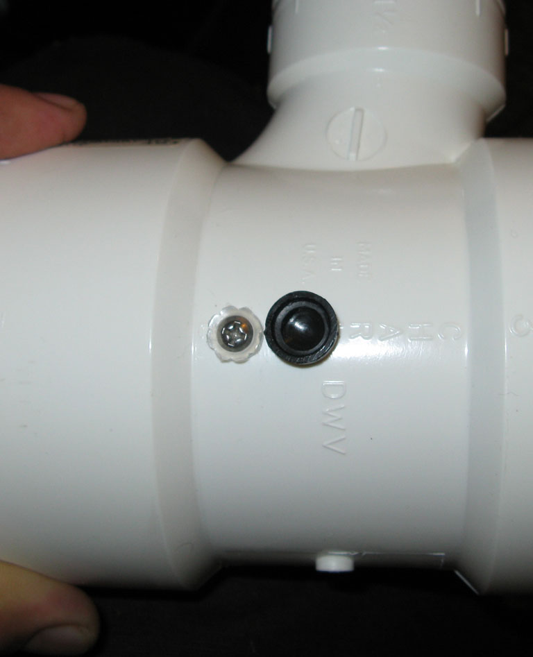

Side view of chamber w/#6-32 screw snap & cover.

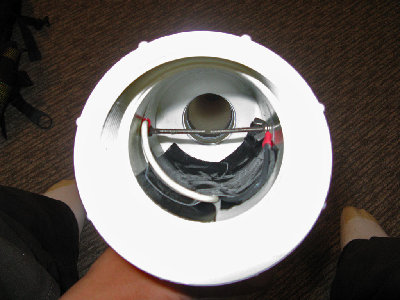

Inside the chamber with #6-32 screws, BBQ wires, wing nuts & Gorilla Tape.

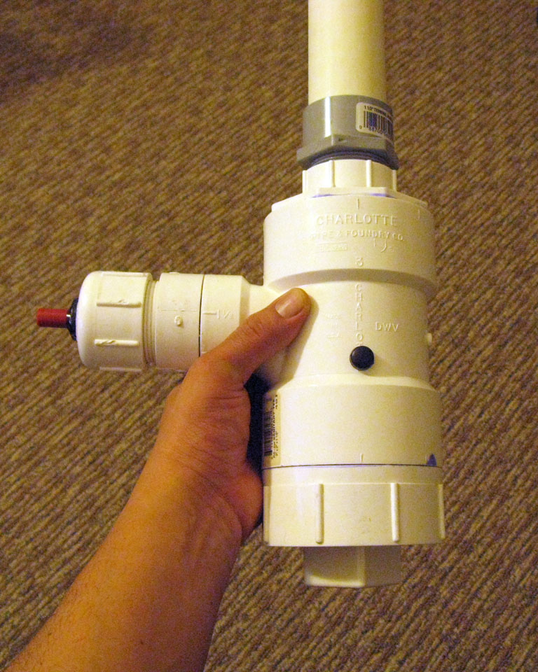

Holding it in my hand.

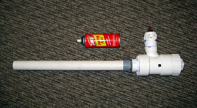

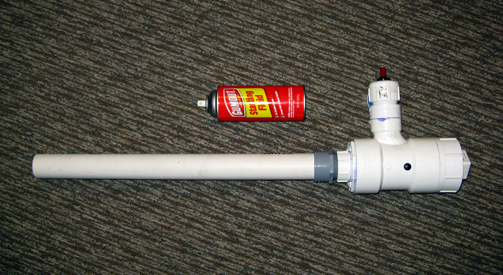

Side by side comparison to a Gumout Starting Fluid can.

Had some ignition issues, so I put some PTFE tape on the very top of the screws where they are in contact with the PVC, and widened the gap about 1mm on each side. So far the dry firing is working 100%.
edit: the extra PTFE tape didn't fix my issues. I seem to be getting sparks up behind the Gorilla Tape.

I widened the gap just slightly, about 4~5mm gap now. I think I've solved my spark issues.
I got some fiber washers on the inside of the chamber, then the ring terminal, then lock washer & wing nut. Before the ring terminal was in contact with the chamber wall.
I've done 40+ dry fires, and they all sparked between the screws.
I am going to look around to find some 1.5" SDR 21 pipe for a tad better fit for a golf ball, and lengthen it to 0.7:1 ratio, about 32in in length. If I cannot find SDR21, I have 7ft of SDR26 leftover from this build, in which a 0.7:1 would be 30.75in in length.
Final, hopefully, ignition solution.  Notice the fiber washers =)
