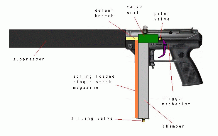

As to the trigger system (assuming the above works), I'm considering two options:
- A hammer valve similar to Brian's (whcih I'm presuming looks something like this that will give one burst of air per trigger pull.
- A push rod that keeps the pilot open as long as the trigger is pushed, maybe not as sparing with air but it would give a "select fire" option.
I'll test the prototype after work and see what happens.

With the current prototype, if the valve works the plan is to turn it into something which looks like suppressed Tec-9 firing either 0.177" BBs or 0.22" pellets from a spring loaded magazine feeding into a tee breech.
