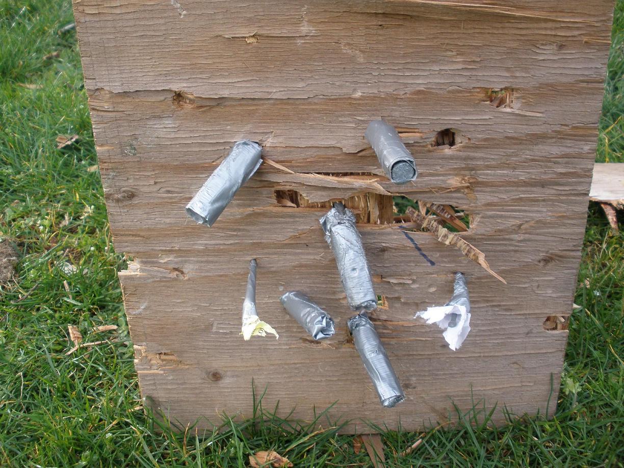

One day i wanted to make a cannon that was a total upgrade from the rest of my cannons. so i made an inline knowing that that would be the most powerful design choice. This cannon is great! it can stick a nail dart an inch into a health tree And explode an apple against a tree at only 20psi.The cannon is over 5ft tall with my 2" barrel. I have a 1/2" bolt action barrel, a 1.5" barrel, a 1inch thin wall barrel, and a 3/4" barrel. It has one problem though... the sprinkler valve leaks. It is leaking between the two plastic parts of the valve and out of the barrel of the gun. if anyone knows how i could fix it or something let me know.
This is my first cannon post so go easy.

entrances. i used darts, marbles an arrow, and my ram rod.
exits
exits
