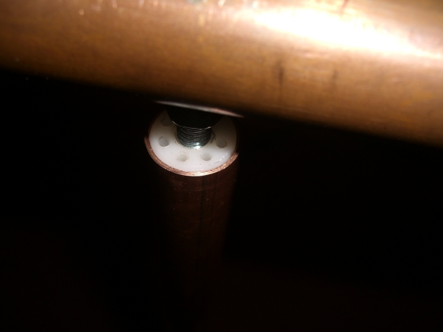

Finally got around to making a pump
Machined the piston head and shaft stablizer from nylon
check valve is a marble sealing a against a washer/rubber washer and a spring
tube is 3/4 copper m
sand made from wood painted silver
handle 1'' copper
First HP Sitrup pump

Nicely made, you failed to mention what pressures you're getting though
Nice indeed. Does it work properly, does everything seal?
Beware of the checkvalve, if it leaks your pump will become a ram.

X2...inquiring minds you know.jackssmirkingrevenge wrote:Nicely made, you failed to mention what pressures you're getting though
X3Gippeto wrote:X2...inquiring minds you know.jackssmirkingrevenge wrote:Nicely made, you failed to mention what pressures you're getting though
me to
but you have a big dead volume between the O ring and the check valve so you will get to the point you compress the air in the cylinder and cant pass he cant pass the check valve

Nice job, what size washers did you use.
