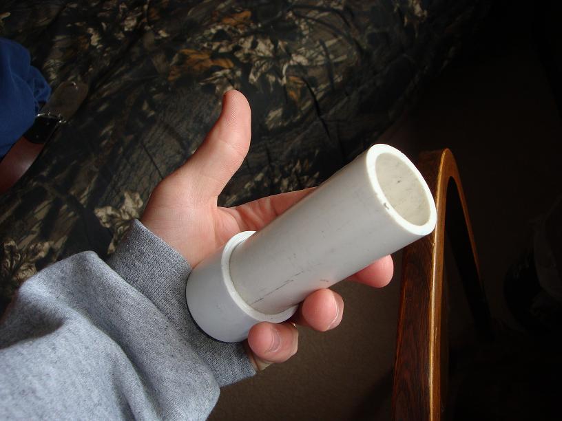

Well going off of JSR's efforts I've decided to make my own prototype.
It's 4" of 1" PVC, I have to let it cure and then add electrodes.
If I am happy with it I will make it without the endcap and cast the end with epoxy so its one smooth cartridge.

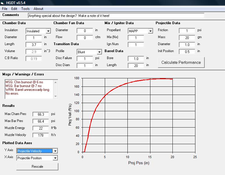

as You can see, I've decided to just go with 1" bore, same as the cartridge for maximum power according to HGDT.
You can see what it predicts below. Testing will come soon.

Looks interesting, are you going to try and make it eject though? with barrel and cartridge diameter being equal I wouldn't be too optimistic about that.

wait but those HGDT results only 178fps on a small caliber spudgun, if your fine with that I wouldn't start working on auto ejection/loading until there's power to spare but the idea of a break open shotgun is sounding pretty apealing

Yea, the velocity doesn't appeal to me too much.
Depending on how testing goes I may slap a 3/4" or 1/2" piece in there and try that.
178 fps is pretty weak i'll admit, i'm looking to at least equal a paintball gun in velocity and ft/lbs (10 approx).
So if i could get 280 fps and at least 10 ft lbs with a .5" or .75" barrel I would definitely go with that.
Tonight I'll be adding electrodes and gluing a coupler to a barrel so I can get a few tests going.

Little update-- After fiddling with HGDT i found my barrel length is TOO long, which is a slight issue. fiddling revealed I could get 213 fps.

UDATE 2: decided to slap a 3/4" piece in there and make it that calibre as HGDT predicts approx 245 fps with a 10 gram projectile and only a slight difference away is 1" bore, plus by choking it a bit it may have more potential for blowbak if i ever go that route. i have mostly everything glued up, curing.

that's probably a good move to size the caliber down I can't imagine a efficient combustion made from a straight pipe where only 1/6th of the pipe is chamber. it should also be easier to make an integrated silencer because I imagine that there will probably be a part that you will put the cartridge into that will be made with 1.25" pvc and aesthetically it you can extend that 1.25" pvc to wrap the rest of the barrel in front of it and there should be enough plenty of space for a muffler between the inside of the 1.25" pvc and the outside of the 3/4" pvc, unless you want a silencer for some water-cooled machine gun look

I do have it all epoxied up with 3/4" inch, but havent been able to test it. I will be sure to post results when i do
