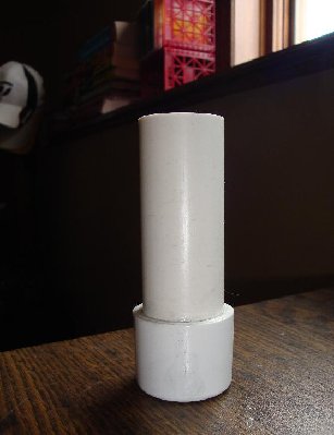

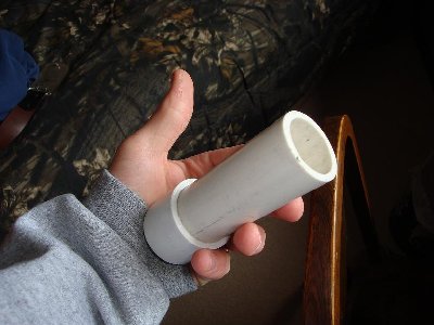

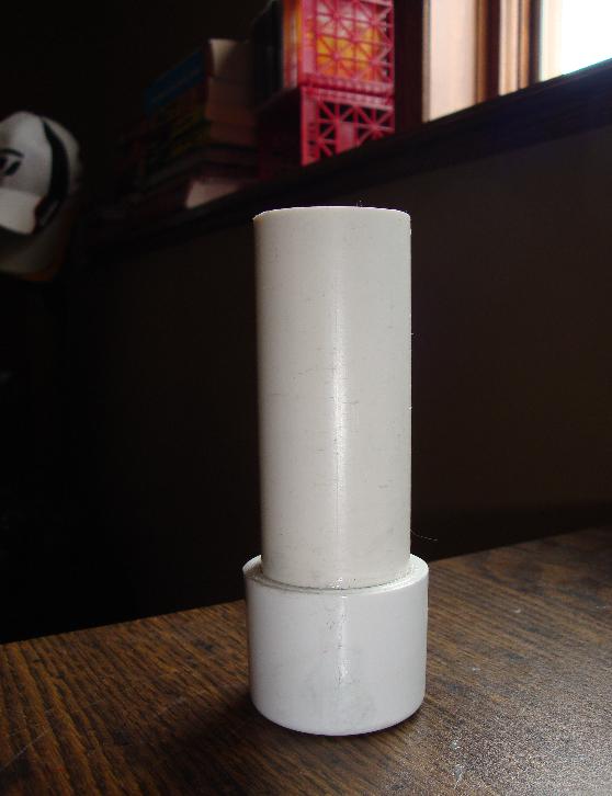

Well going off of JSR's efforts I've decided to make my own prototype.
It's 4" of 1" PVC, I have to let it cure and then add electrodes.
If I am happy with it I will make it without the endcap and cast the end with epoxy so its one smooth cartridge.

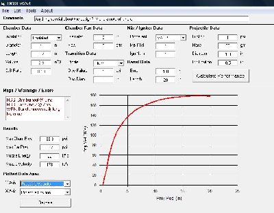

as You can see, I've decided to just go with 1" bore, same as the cartridge for maximum power according to HGDT.
You can see what it predicts below. Testing will come soon.

Looks interesting, are you going to try and make it eject though? with barrel and cartridge diameter being equal I wouldn't be too optimistic about that.

In that case you should have a workable project, cartridge power is irrelevant to its function. Good luck

wait but those HGDT results only 178fps on a small caliber spudgun, if your fine with that I wouldn't start working on auto ejection/loading until there's power to spare but the idea of a break open shotgun is sounding pretty apealing
Yea, the velocity doesn't appeal to me too much.
Depending on how testing goes I may slap a 3/4" or 1/2" piece in there and try that.
178 fps is pretty weak i'll admit, i'm looking to at least equal a paintball gun in velocity and ft/lbs (10 approx).
So if i could get 280 fps and at least 10 ft lbs with a .5" or .75" barrel I would definitely go with that.

Little update-- After fiddling with HGDT i found my barrel length is TOO long, which is a slight issue. fiddling revealed I could get 213 fps.
Also I have an idea for getting more power out of it, if I'm not interested in getting ejection/blowback...
Will be posted later
UDATE 2: decided to slap a 3/4" piece in there and make it that calibre as HGDT predicts approx 245 fps with a 10 gram projectile and only a slight difference away is 1" bore, plus by choking it a bit it may have more potential for blowbak if i ever go that route. i have mostly everything glued up, curing.
