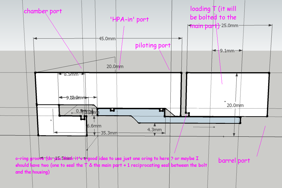

damn designing this is much more difficult than I thought
what should be the gap between the bolt and the housing ?? to me it seems that 0.2mm would be ok, but that's just a guesstimate
another question... how much larger the o-rings should be than the clearance + o-ring groove depth ?
and finally.. is it a good idea to use just 1 oring to form a seal between both the bolt (reciprocating) and the valve housing as well as between the main part of the valve housing and the loading T (which will probably be bolted to the main part)
I've added some pics of it (all of them are cross-sections... uhmm halves of cross-sections - I found it easier to design it in this way)
8,731mm closeupoforingrooves.png (20.47 KiB) Viewed 4401 times

POLAND_SPUD wrote:what should be the gap between the bolt and the housing ?? to me it seems that 0.2mm would be ok, but that's just a guesstimate
Personally, I like to build with .127mm max clearance.
In your design, you need select a bore size that's close to a standard o-ring.
http://www.marcorubber.com/sizingchart.htm
The Machinery Handbook contains more technical info than you could possibly need or want. All the info on sizing and machining of static and dynamic o-rings can be found there. You can't simply guess at dimensions and clearances. They're in the book.
http://www.amazon.com/Machinerys-Handbo ... 425&sr=1-4

thx
the only problem is that AFAIK AS568 is used in the USA and it isn't popular here... I am in the process of obtaining the Machinery Handbook but again I am afraid it might be useless for me as it probably uses imperial units...
well at least now I know that there might be a similar polish book so I'll try to find one
anyway I think I'll follow this guy's advice clicky
and use it to design the seals 'around' metric o-rings
though there are still a couple of things I don't know...
like for example is height important (meaning cross-section of orings) ? I can get orings with 1mm or 1.5 mm CS but I don't know if they are not too thin

Well, will your oring meet the 30% criteria? I.E> with the o-ring groove in place, will the outside diameter allow it to be compressed 30%? (this is for moving parts, a 40% compression is recommended for static seals).
The o-ring in the groove should compress to 70% of its original thickness.
