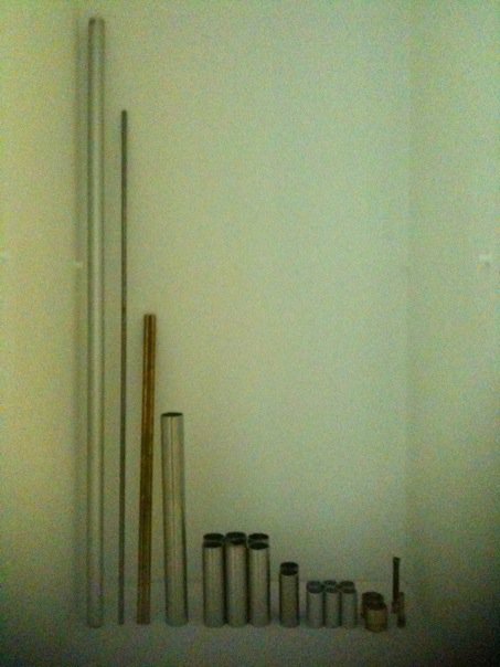

Here's a peek at what I'm working.
P.S. Some of the parts are still in the workshop, hopefully they will be machined soon by my ever-procrastinating friend.

Looking good, and on a bigger scale than mine so it's got a better chance of working
What calibre? Looks like at least 1/2"

I'm impressed by your ability to guess the calibre from such a shoddy photo.
It is, sir, exactly, 1/2 an inch.

Schraders are about 1/4" and the barrel tube looked about double that so it wasn't such a hard guesszomgwtfbbq wrote:I'm impressed by your ability to guess the calibre from such a shoddy photo.

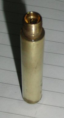

Update here in order to avoid hijacking CpTn_lAw's topic, in the light of his observations I've made a new prototype with as tiny a spark gap as I could manage, basically identical to my first prototype but with an added piece of piano wire:
... to be tested soon.

daccel seems to have hads some success with steel wool ignition in his BACH design. I need something more maintenance free though, I have various types of nichrome wire in my spares box, mostly from scrapped heat guns/hair dryers, which should do nicely. A short length of effective "gap" will get very hot even with relatively low current across it, the important thing is that it survives intact because given the... well, "permanent" nature of the cartridge construction, you need to destroy it to access the wire... unless I come up with something that attaches to the stem of the schrader, hmmm...

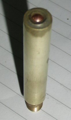

Here's a couple of views of the finished product, in that position the BB can hold around 30-40 psi, pushed further in it will hold at least 200

Wow the diameter is 1/4 inch? That's really small! And 200 psi is really sexy.
