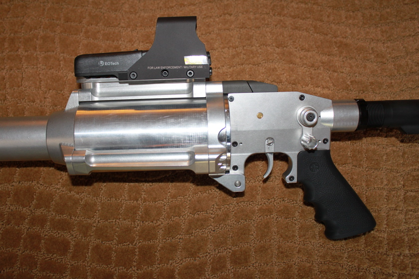

VARGAS is designed to be a kinetic energy device cartridge system for less lethal applications. Cartridges are designed to be used across a platform of different devices.
The device pictured here is the SR-1
SR-1 specs
Length 36" - 40" depending on stock extension
12" barrel (does not include internal cartridge bore)
40mm barrel bore
thumb operated breech opening
adjustable breech latch (to account for wear and closure tightness)
air stripping type muzzle brake (USGF brain child)
custom Picatinny type rail with EOTech 552 sight
Hogue AR-15 pistol grip
AR-15 carbine type collapsible stock.

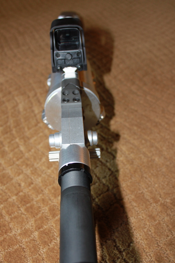

shooter view
shooter view

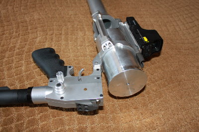

breech open cartridge pull out
breech open
breech open
sight rail, cartridge cage close up.

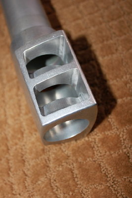

USGF air stripping type muzzle brake.

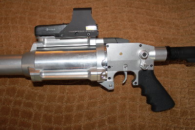

Full view
Full view

jrrdw wrote:How is the cartridge refilled? What all is that going to take? Cost?
The fill station hangs on the the cartridge rim and fills through the internal cartridge pilot valve. Takes about one second to fill.
